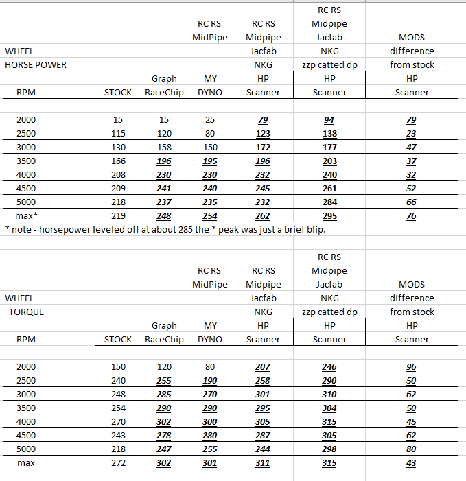

FIRST - the HEAD TO HEAD Dyno Vs HP with on-board sensors (generic pid) if I recall.
THERE IS A CAVEAT HERE - I ADDED the JAC VALVE AND NKG 6510 SINCE THE ORIGINAL CHART, SO I EXPECTED A SLIGHT POSITIVE GAIN. There is a slightly positive gain in the HP SCANNER Graph. YUP another curve ball.....
SO THIS- Represents the Head to Head Dyno vs Internal Sensor Power Chart. *with a known new variable, the jacfab and the nkg 6510 @ .0275 plugs. Which were put in, after the original chart.
The results are here: THere is a reasonably Strong equal correlation bewteen Dyno and Sensors IHMO.

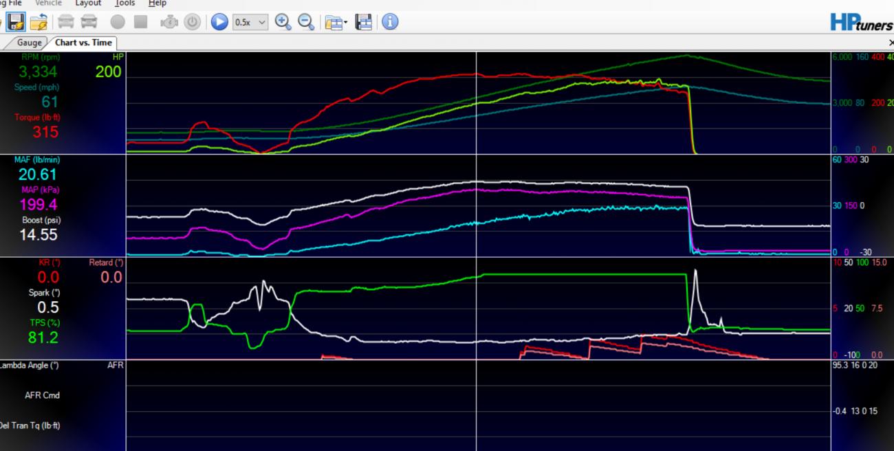

I have the static pic AND a moving picture - ONE THING TO NOTE- is the Knock Retard. I also got enough PING at the dyno test, that the tech pointed it out.
HERE IS the Static Image of the comparison test run.
Name:  comp dyno HPs.jpg
HERE IS the above image in playback mode. IT has the KR and the boost and the other good metrics in motion.
https://youtu.be/w4IBClB62rs
GREAT! That is the first point.

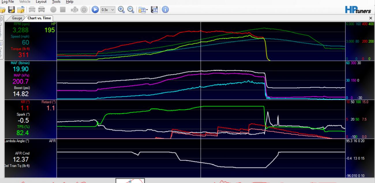

THE SECOND POINT Is taking my new TOOL and getting a reasonably reliable Graph with the Newly Added ZZP Downpipe. Same thing, no tricks no smoke and mirrors or partial or cropped readings.
Here is my Current Chart that shows my area of most interest seems to be a reduction in KR! Its a positive direction.
Also what seems to be implied is the stock turbo is pumping its little heart out and its fully maxed in its function. I am not exactly sure why I think that, but I do. ANyways here is the current setup as it sits in my driveway.
RC RS 5/6, NKG 6510 @.0275, Borla resonator, ZZP Catted DP, JacFab.
295HP/315tq, +33/+4 zzp catted DP effect combined with the other mods.
Static pic-
Video - https://youtu.be/qrgWg2DIqPY
KR fixes ideas, meth injection / cutout exhaust / reduce the tune (:

Wook, holy shit. Thank you for taking the time to do all of this. I am absolutely loving it.
Looks like the ZZP Catted DP was a worthwhile adventure. What is your take on the "feel" of the car with the DP added? How do the changes in the low-end, midrange, and high-end feel to you..."seat of the pants" type thing?

Oh yeah, your question. Zzp chatted DP is the shit. Totally woke the car up. Almost like the same jump to tune vs stock.Perfect "in the pocket" type of drivability. You will really appreciate with the xlr. And then ur tune of choice will work fine and multiply the benefit of the breathing room.

No discernible loss in the low-end rpm ranges? That's awesome to hear. I'll be ordering one today.

Updated table of power results.

Awesome stuff, Wook. Can’t wait for my downpipe to be in. At that point we will have very similar setups and I’ll find a dyno to run as well. 295 hp and 315 tq at the wheel is nothing to take lightly! While the addition of the DP only rose tour max tq by 4 ft-lb, the jump at 2000-2500 rpm really sticks out to me. I’m pumped.

yeah. so wrapping my brain around the torque and hp. So torque is measured and HP is calculated using RPM with a variable factor of 5252. That is how they are linked. The how one reads the chart is "how much work is it taking (HP) to make the force applied (TQ) to the contact patch on the tire", using 1-1 which 4th gear on M6 is 1-1 with the obvious inherent errors, like factory calibration for tire size, air pressure diameter, slippage, etc. but its close enough for our purposes. You can get much higher TQ readings using more leverage with lower gears, but usually in reporting stuff, its assumed your talking 1-1.
Also you may not get the right result if you are trying this on a level surface. You have to use a good incline so all the work of the engine is required and can be measured. That's why on my dyno run, I could smell some rubber burning off the rollers. I found a spot that is about 3000 ft of steady incline with an on ramp so I can start from a slow speed in 4th, and get the full pull to about 5k before it gets dicey.

That's some good explanation right there. I'll add if your auto 1:1 is 6th gear but the way the auto is geared your closer to actual pavement to tire in 5th gear.
