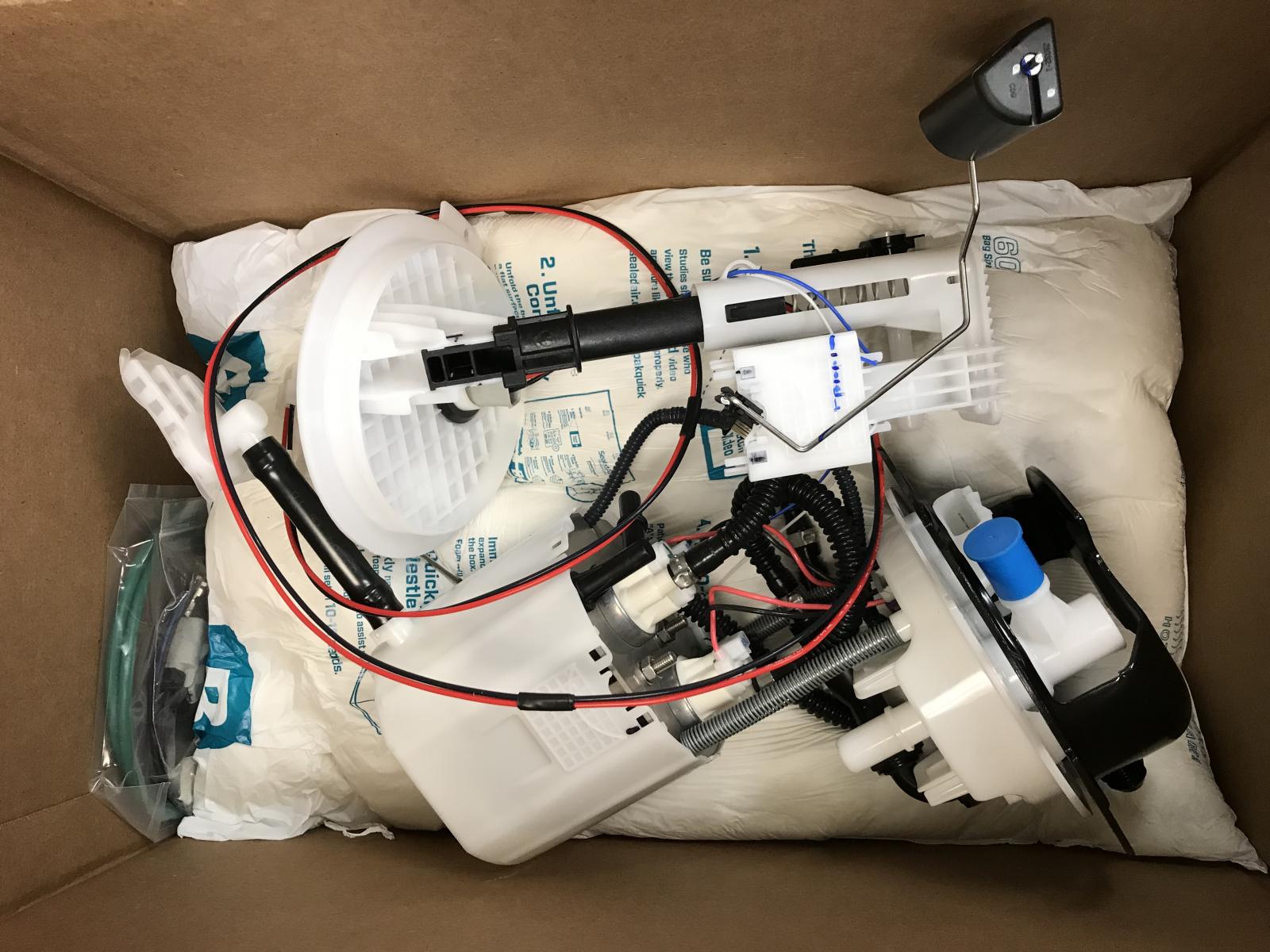

We needed something better and I saw Lingenfelter's advertisement for the dual in tank system - phone call, credit card, and a couple days later we had a new option.
Name:  Photo Dec 11, 5 20 28 PM.jpg
The Lingenfelter system has 2 - 450 l/hr pumps in the stock basket. It requires some additional wiring, but otherwise was pretty easy to install.

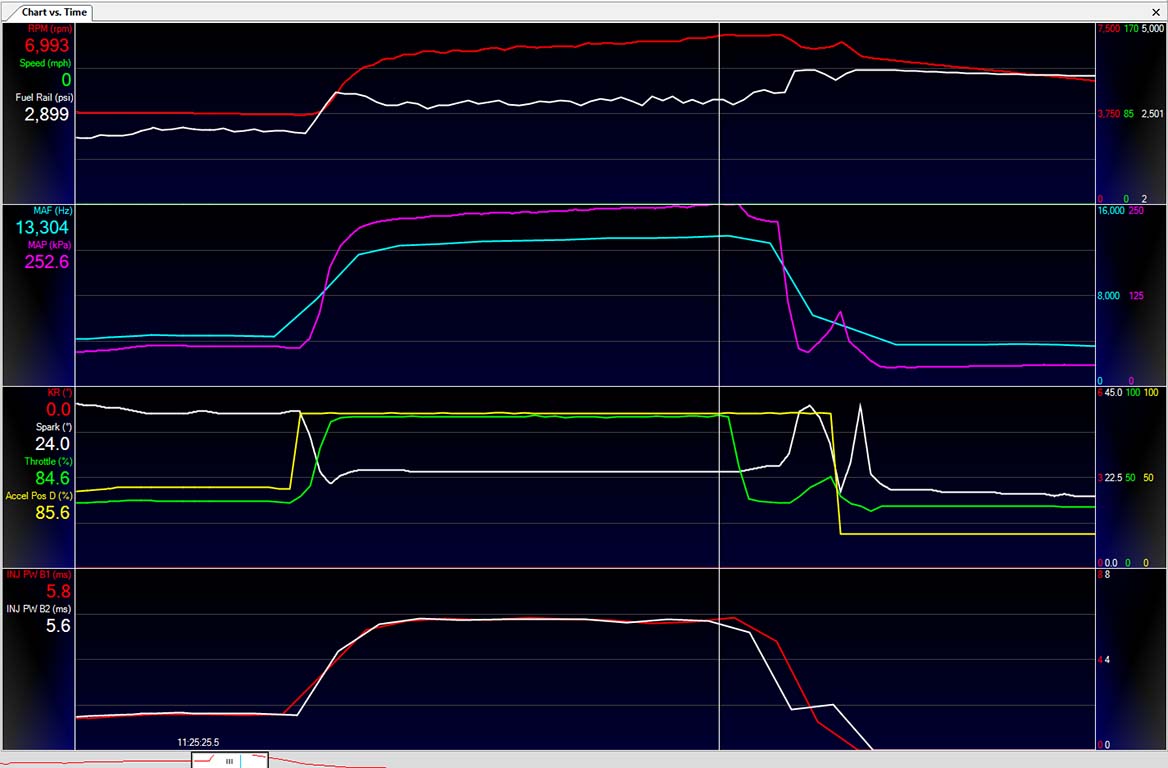

Now with the dual in-tank pump system the low side fuel pressure remained at 75psi+ for the pull (which was dyno logged) but from the HP tuner log you can see that we we able to hold HP fuel pressure and a 12.0 A/F ratio across the pull to 7K RPM with up to 252 kPa of manifold pressure (22psi boost).
