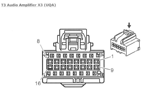

Hey I noticed you posted the pin-out for the Bose thing in the trunk a couple years ago. Do you happen to have diagrams/pin-outs for the other connectors on this thing?

Here is an older thread with the info..note the incorrect pinout for the rear deck speaker...diagram is backwards for that speaker if you decide to use it
https://www.camaro6.com/forums/showthread.php?t=488428
