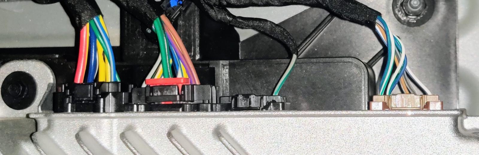

Old 11-17-2023, 10:56 PM   #10
The Maverick
Somewhere in the Kalahari
The Maverick's Avatar
Join Date: Dec 2017
Posts: 820
Originally Posted by ctrlz View Post
I think if you get Bose in a 4-cylinder or V8 car you get the ANC stuff. V6 cars don't get ANC. So my title of "2SS vs non-2SS" is misleading.
[snip]
X3 has only pin 1 occupied in a V6 installation. The other 5 wires listed are for the ANC system (crankshaft position sensor and door microphones)
X4 (last chart, unlabeled) also appears to be the same in both configurations.
Pins 3-6 I can see occupied in a number of posted photos.
Pin 14 is definitely occupied in a 2SS.
Pins 7,8,15, and 16 as shown in this diagram for the NKE option are not occupied.
Correction to what I posted here yesterday: My V6 3LT with Bose lacks the ANC wiring on plug X3, as described above, but it looks like it does have the NKE (Noise Control - Electronic Sound Enhancer) wiring as indicated by the RPO on my build sheet. Not certain what the NKE is, and a forum search led me to this thread.
In regard to the following comments, there is nothing special in the menu screens that I can see, other than the speed-sensitive volume control...
Last edited by The Maverick; 11-18-2023 at 12:46 PM. Reason: Completely updated the post because I had confused the X3 and X4 connectors in what I first wrote
Old 11-18-2023, 04:14 AM   #11
Anjilslaire
Anjilslaire's Avatar
Drives: 2021 3LT RS A10
Join Date: Nov 2021
Location: South Sound, Washington
Posts: 486
Now that's interesting. So our 3LT doesn't have ANC then?
Anjilslaire is offline   Reply With Quote

Old 11-18-2023, 12:49 PM   #13
The Maverick
Join Date: Dec 2017
Posts: 820
Note that I updated my post above from yesterday - I had confused connectors X3 and X4 in my original version of the post. I also added a photo from my car.
Old 11-18-2023, 10:10 PM   #14
gblaue
gblaue's Avatar
Drives: 2017 Bright Yellow ZL1 6spd
Join Date: May 2010
Location: Central MA
Posts: 658
Attachment 1141040
It gets the engine rpm signal over the high speed CAN.
