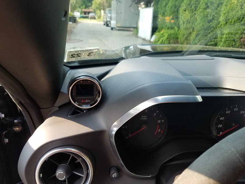

Ok update...
Use the sound tube pass through cover to get wires through firewall. Drill a hole in it the size you need and plug it up to keep water out afterwards. This is how I passed my WBO2 cable through.
Do not use any of those options above for 12VDC power for a Wideband O2 sensor (too high current). Add a fuse to the fuse box and run power back through the sound tube plug.

gauge is powered by OBD2 port. WBO2 sensor kit is grounded at pin 5 of OBD2 (common ground to keep gauge accurate) and then ran a new positive connection from fuse box
