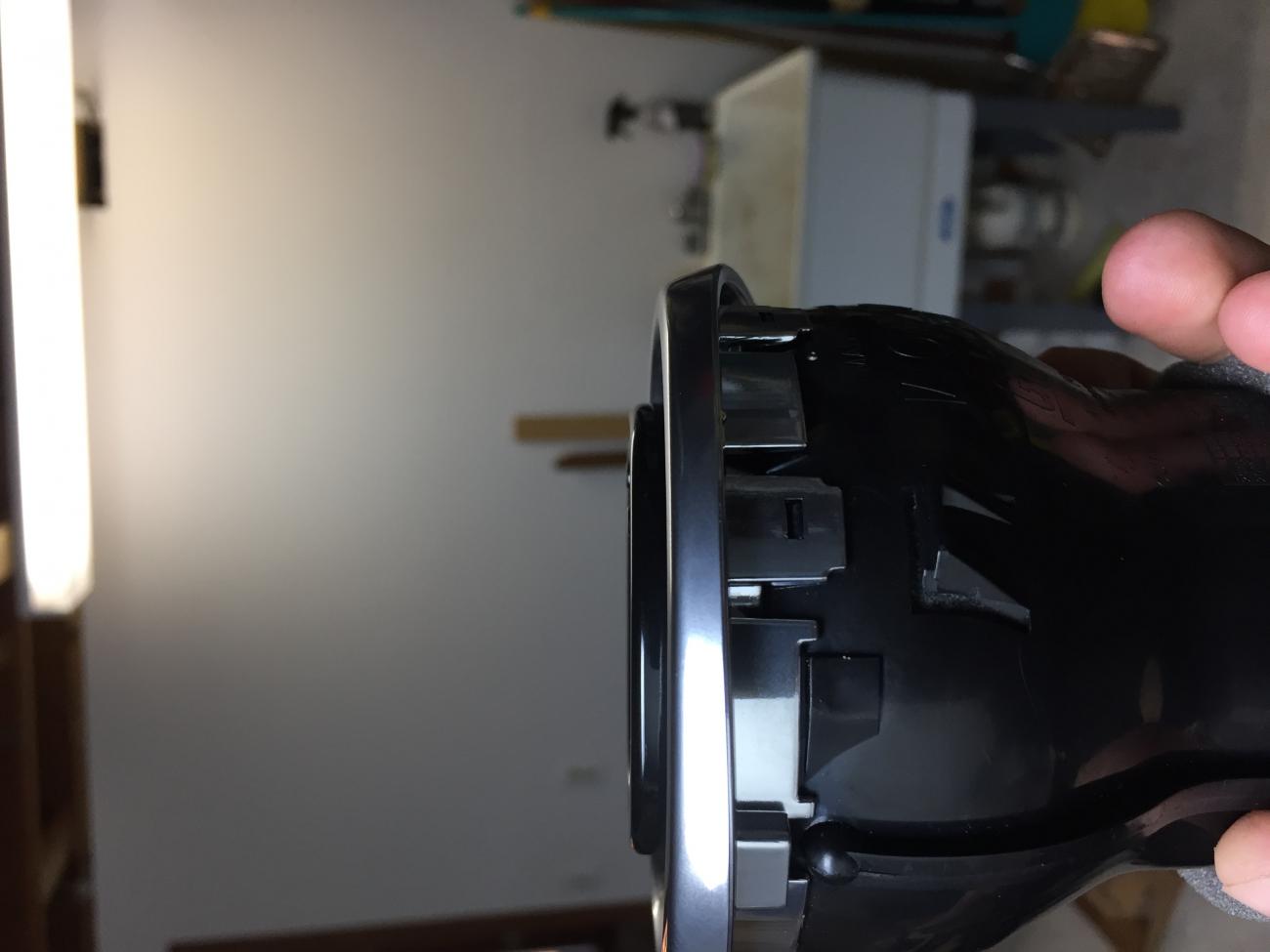

[QUOTE=TMS;10112915]
Originally Posted by Hyperlinkblue View Post
On whenever the car is running. All the time.
Sent from my SM-G950U using Tapatalk
Awsome, im going to go this route then. I currently have the left vent pod out and the center cut out partially. Im going to make it hold the aem wideband gauge..... if it comes out good, ill post pics on here if you guys want. A new vent and besel totaled about 50 bucks... so nbd, i just dont wanna goto a dual gauge pod. I allready have a single pod with a aero force. Which i didnt want to use there wide band because its not hp tuners friendly, the aem 30-0334 is pass theough, so it hooks upto the obd port then i can plug in HPT or what ever other scan gauge or scanner im using behind it, and its HPT friendly. This will be interesting lol
Hyperlinkblue is offline   Reply With Quote

Almost finished with the custom vent pod
