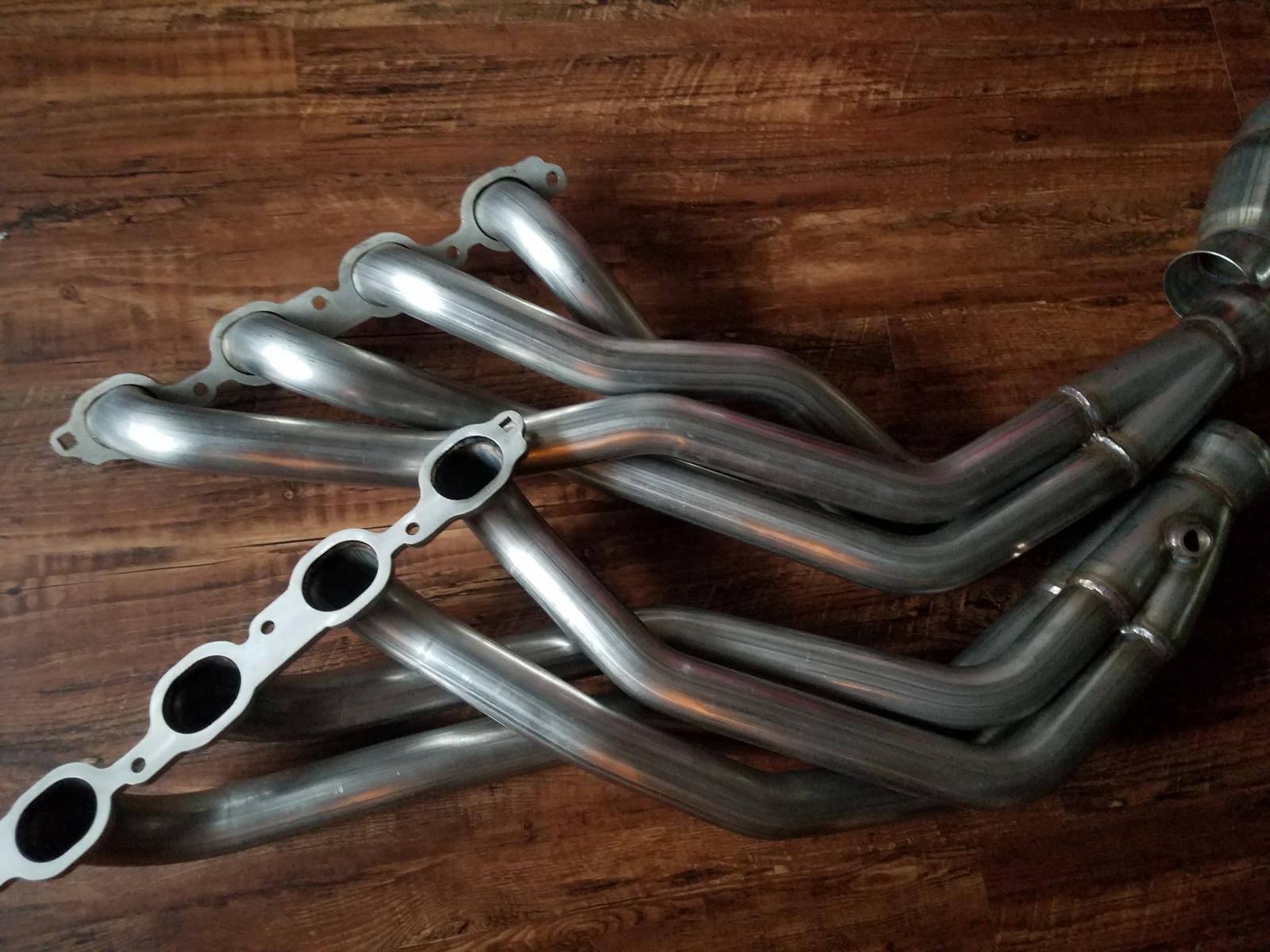

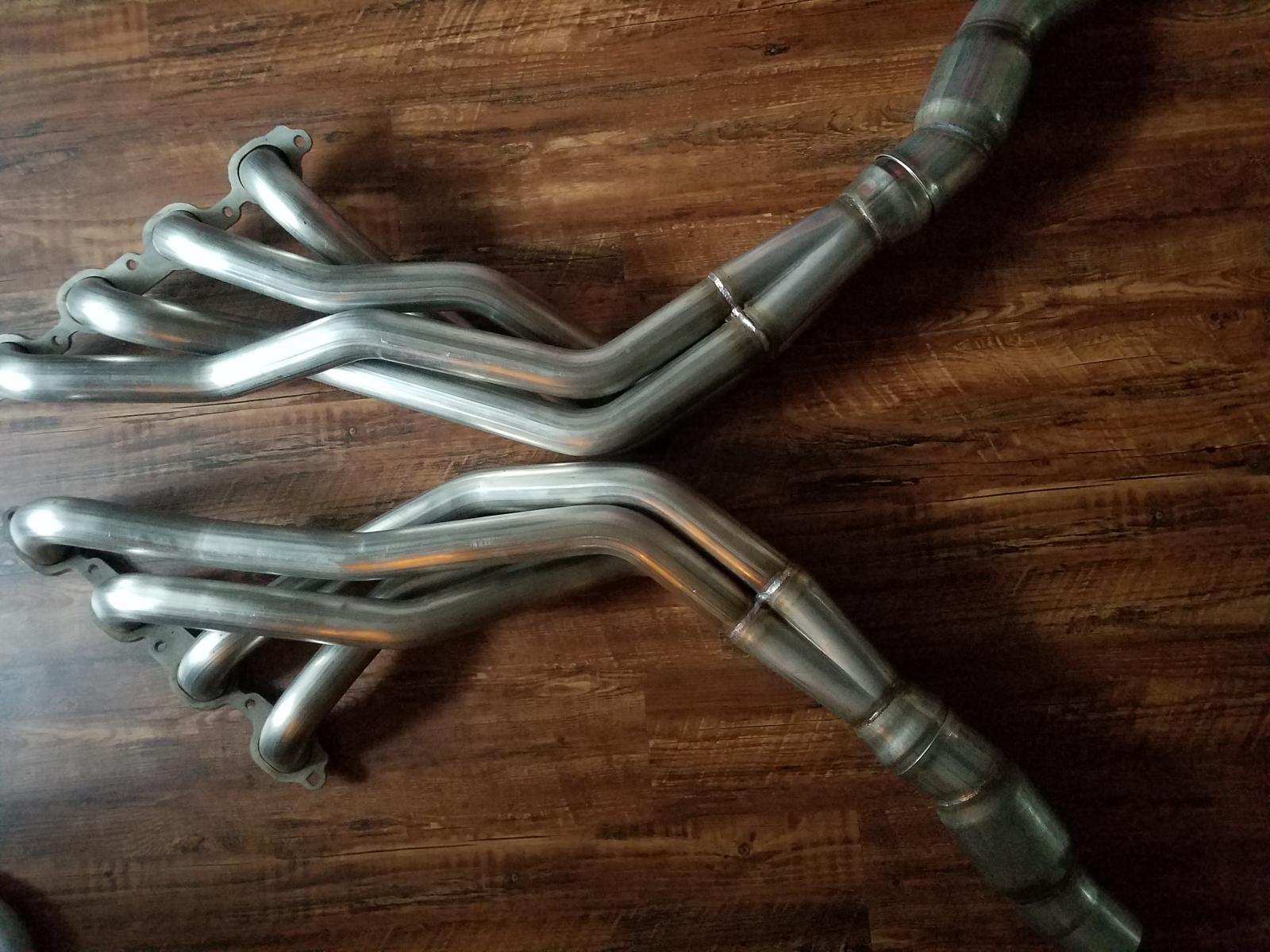

Ceracoating my catless headers this week and i know ill want an air fuel gauge in the future so im going to weld a bung and cap it for now just not sure the placement ive seen alot of people say drivers side close to factory o2 but nothing about before or after, or angle upstream or down.... any help would be much appreciated. Thanks guys

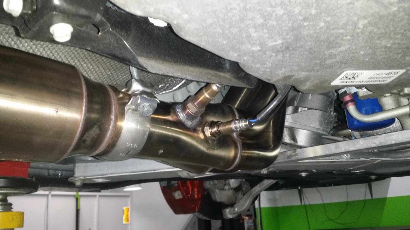

Driver's side in the header just past factory O2
Worth a thousand words.. I appreciate it man

No problem. And you can fish the wiring through the sound tube hole.
