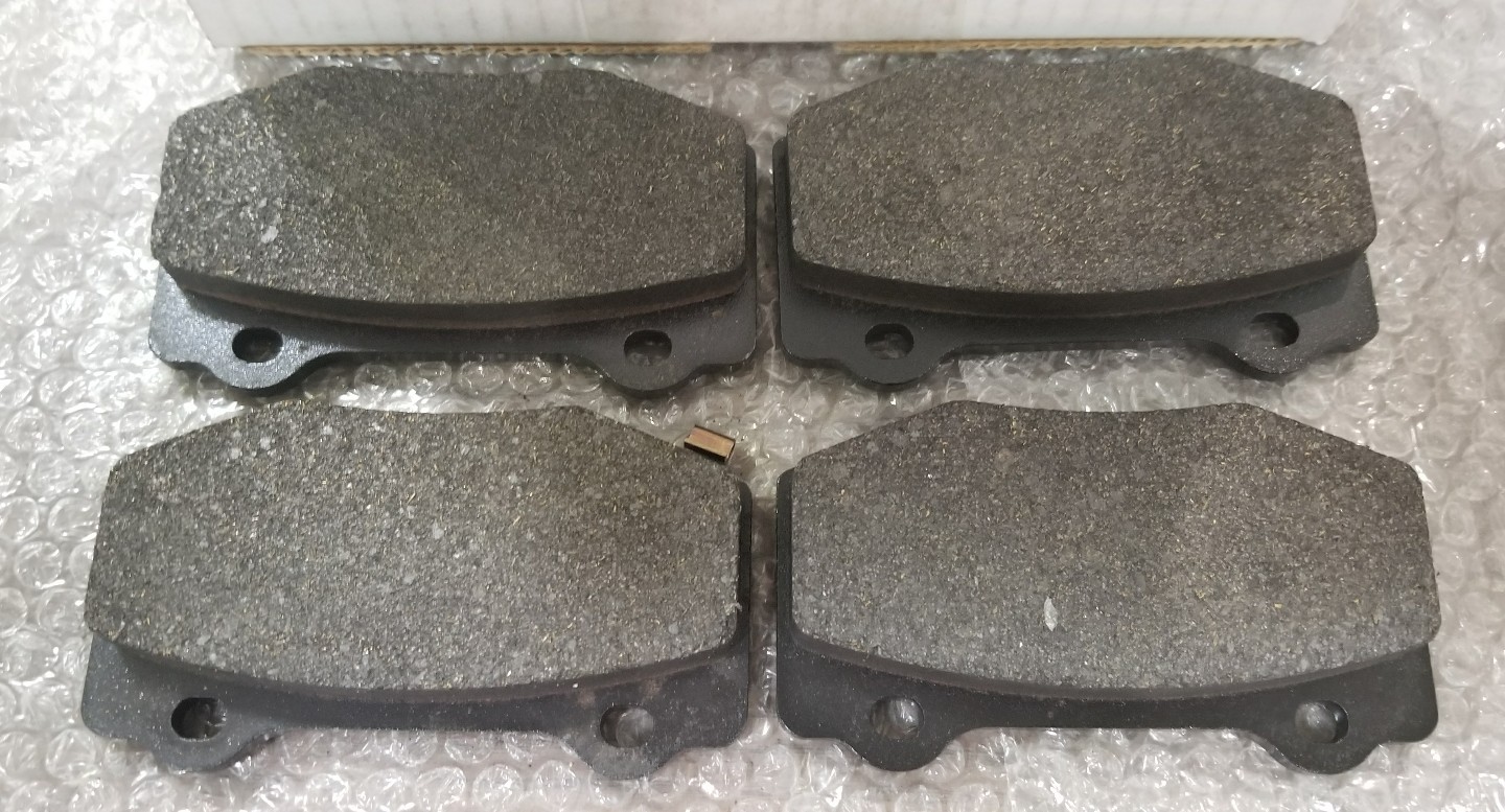

I’m pretty sure the rear calipers are the same, yeah? Same brake pad part number.

The rears definitely do look different, but they appear to be the same pad internally.
Rear J6H pads are slightly bigger a bit different shape.
J6M rear pad:
RUQWIKR is offline   Reply With Quote
