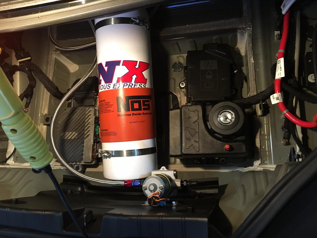

Just put this model NX 1503 in my build. Tank and pump in the trunk and regulator will be positioned as close to the solenoid as possible. I will be running the pump soon to set the pressure to 8lbs and will be putting a return tank in the engine bay. Still have to drill a hole and vent tank in the trunk for safety concerns. Wiring not complete, going to order custom lines measured for plumbing on Holley High Rise so it does not look like an octopus. LPE box is on order for Lingenfelter in order to retard timing for track runs. Still thinking on which level of shot to start with. The kit came with 100,200,300,400,500.
Rational I will start with a 100 shot, then 150, 175, and the goal is to be at max 200 shot. This all depends on how the 150 shot feels. At 200 shot and running race fuel in stand alone fuel system should be fine. But it depends what the dyno reads in HP power at 150 shot. With a plate system that sprays in each runner the HP can exceed the nozzle size and potential manufacturers estimate.
My cost was $389 for tank. (lines/fittings/gauge added another $200)
My build is Natural Aspirated so no high boost stand alone fuel system which is a lot more and probably like the quoted post said.
