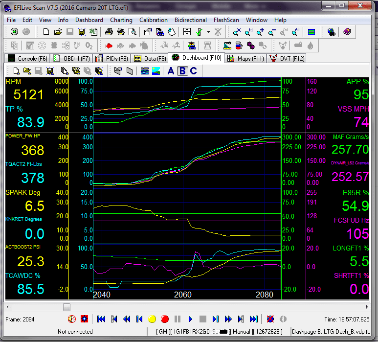

Cool E85 Conversion for 2016+ LTG
Hey guys, Kevin (Evil-Bee-NH) contacted me that you were having trouble with the E85 Flex fuel conversion. Here is a link to my instructions which includes the pin you need to connect with.
https://www.dropbox.com/s/tc6gn5nzzh...rsion.pdf?dl=0
The last time I tested the HPTuners editor they had not made the correct changes to activate the pin - you could flip the E85 switch in the VCM Editor and it would not read the sensor properly even when connected to the correct pin.
I have already done an E85 flex conversion for a 2016 Camaro owner that I know posts on the Camaro6 forum, not sure why he has not chimed in yet but maybe he is not very active on the forums.
FYI - I am a global distributor for both HPTuners and EFILive. I prefer to use the EFILive Autocals for a number of reasons. In both instances, neither EFILive or HPTuners editors worked properly to activate the flex fuel sensor code. I spent months developing and testing my own code to make the system work on the E80 ECMs. I can save this code into either EFILive or HPTuners file formats to flash program the ECM using their hardware. I only offer to tune using the EFILive system as the data logging parameters (pids) I require to remote tune customers are all available using the EFILive handhelds and some critical pids are still not working properly on the HPTuners VCM Scanner software.
This is a data log from one of my 2016 Camaro 2.0T customers running my flex fuel system - you can see the FSCUD signal (flex fuel sensor frequency output) and the E85 value this represents in the data log. I have hidden his full VIN protect his privacy.
hope this helps.
