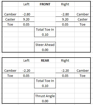

Do you run a different alignment for the high oval to reduce chances of smacking the wall?
I've heard/been told that it is a good idea to run less camber to avoid a blowout on the right front.
This is the alignment that I normally use. I can change the caster back to ~ 7.5 (stock), but don't see that as something affecting tire wear.
Also, I target 35-36 psi hot for the tires, do you target higher or lower?
Running the G3 non-R tires, 305/20 square

Hankook, Michelin, & Pirelli guides (for competition tires) have info regarding places like Daytona. For example, in the Hankook racing tire guide: "For tracks with sections of high-banking, or “rovals”, the camber settings must be significantly reduced because the track’s banking dramatically increases the load on the tires." I've seen anywhere from 0.5 to 1.5 less on the RH side and the same to around 0.5 more added to the left. I have not ran Daytona yet but the physics make sense on why I'd change my settings.

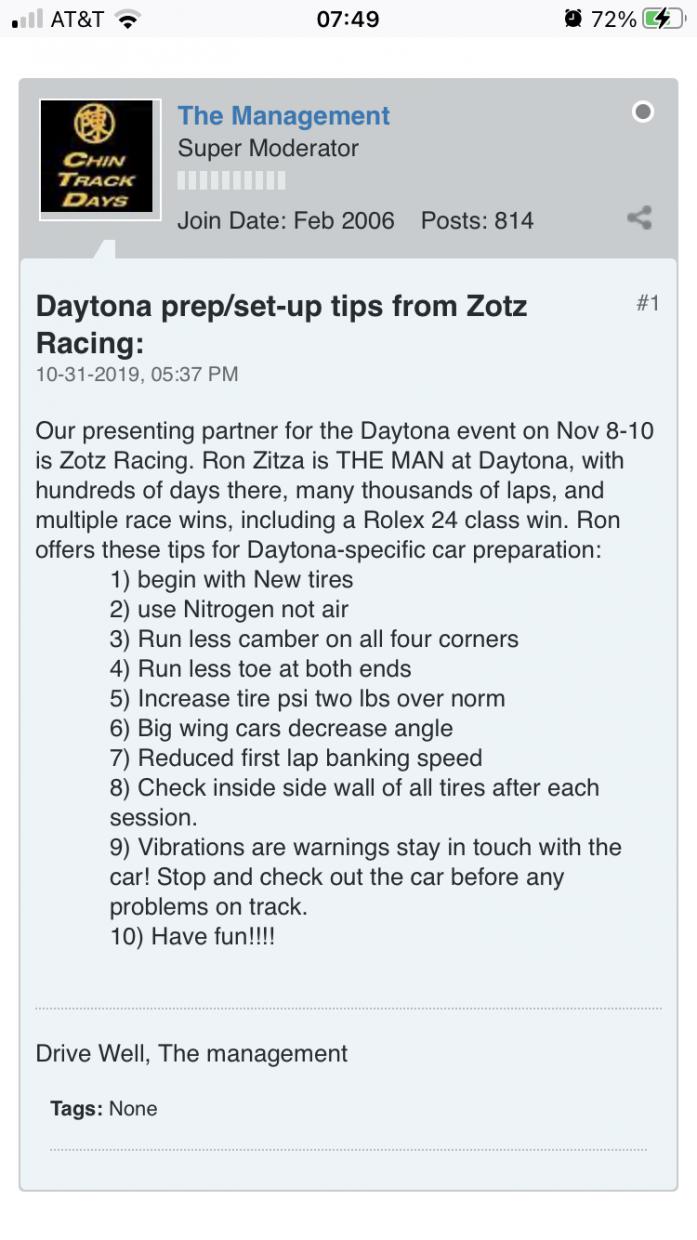

I sent emails to both Chin and Goodyear to get their input, appreciate the common sense cdrptrks.
Jim Pomroy at Chin responded right away, thanks for that! He pointed me their forum
https://www.thechinforum.com/forum/t...om-zotz-racing
If I get a response from Goodyear, I'll add it too.
Thks to RUQWIKR for mentioning this the other day at the track.

Having run Daytona myself in the past, I ran roughly -2.8 FR, -1.5 RR and -.5 on the LF/LR. That was for 45 minute races and such. But I was on Hoosiers and not street tires. My tire wear looked amazing and grip was great throughout. But I know the compound difference is vast between us.

Camber helps tire wear mostly with this platform to me. By that I mean road courses. If braking is a big deal from a very high speed entry to a slow corner then less camber might be better so that you have the more contact patch straight on.
COTA is kind of a mix, high speed straights into hairpins along with slower technical sections. You'll cord the inside of your front tire with camber > -3.0 in my experience mainly going from 135-150+ mph to 40mph into the hairpins. < -2.8 the outside cords. So around the factory track camber works pretty well for even wear and good braking +-.
