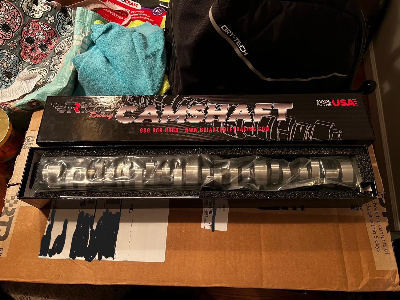

UPDATE: The shop that maintains my car has pulled the engine out and it looks like the bottom end is actually in great shape. The oil pump never picked up any fragments from the cam/lifter. So we are going for a top end reuild with a custom cam from BTR. I will continue to save for a crate motor in a year or so, but for now this will be a more budget friendy for me.

Custom grind cam has officially arrived!
Motec will be ordered soon. Trans going to a trans shop to be rebuilt and getting new 5th/6th gears while that happens!
