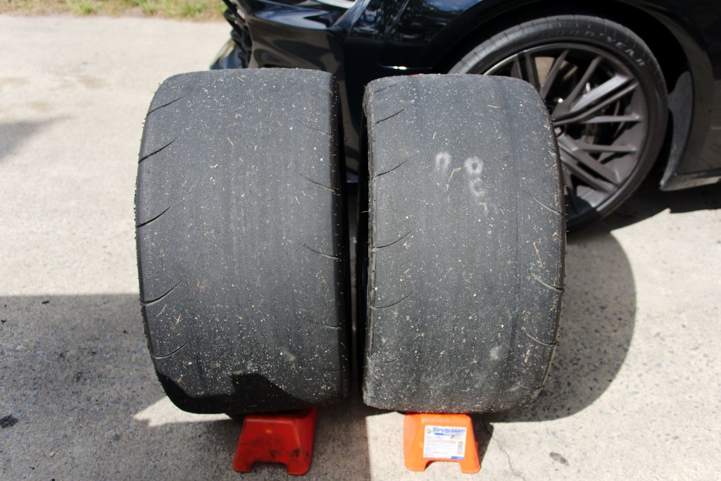

Here's my existing DRs. Facing the camera is the side with the most wear. The center treads are no longer visible. The opposite side has about 1/32" to 1/16" of visible tread. I've notice the same trend on my stock tires.

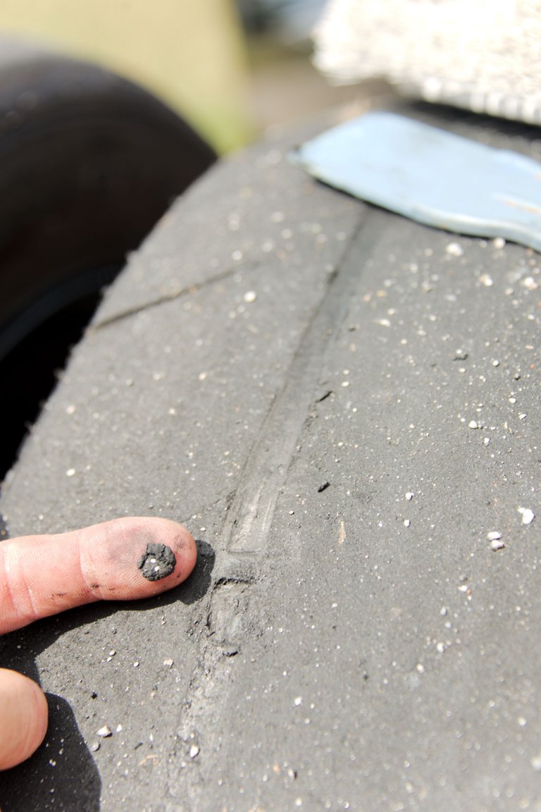

Here's the other side of one tire with melted rubber scraped out of the groove.
[Tire Wear]
How many more passes do these have in them? I'm thinking maybe 3 if I only do one 5-sec line-lock burnout and the other 2 rolling burnouts.
Unfortunately, tire wear has not been even. Each tire has worn pretty evenly across the tread from side-to-side but rotationally they've worn more on one side than 180 degrees away. To me this calls the wheel balancing job into question. I'm assuming that GM has balanced the rotors and I know they've worn evenly.
Where to you guys get your wheels/tires mounted and balanced? First, they have to have equipment that won't damage painted wheels. Second, they have to be able to simulate over 150 MPH on the balancer. Would you bring them to a dealer service center, local auto repair shop, or a speed shop? I'm leaning toward a speed shop, although there isn't one I trust within 50 miles.
Left side tire always wears out before the right. This seems to indicate that the eLSD is favoring the right side for power during wheel spin. It seems to me that an eLSD should be capable of tuning this bias. I doubt whether a dealership service dept. is equipped to do this, though. Even if a speed shop tech/tuner was able to do it I'm sure this type of 3rd party adjustment is a warrany buster. Dare I ask if anyone else has tuned the eLSD?
A workaround would be to rotate tires from left to right sides periodically to even out the wear. This would require unmounting the tires and swapping wheels so the inboard sidewall faces out. This way they'll rotate in the same direction. This might work with the DRs since the tread pattern is symmetrical. I doubt this would work on the stock Goodyear tires since the tread is decidedly asymmetrical.

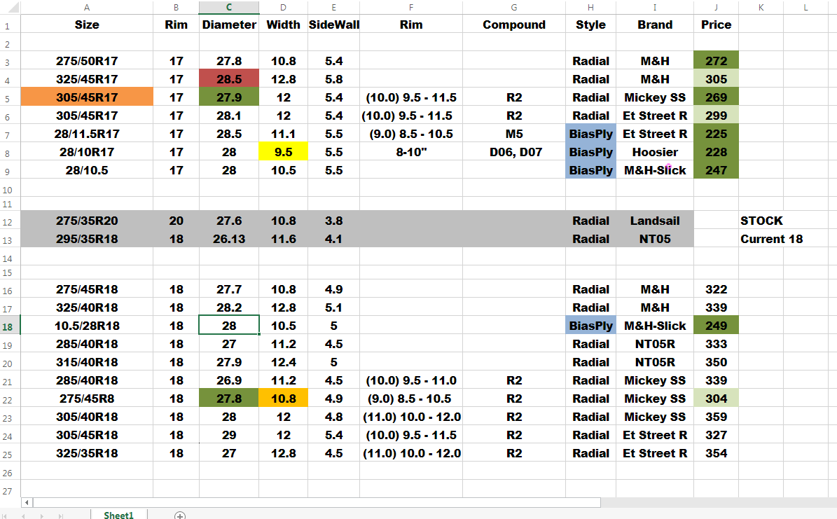

I'm currently in the same boat as you on deciding which tire to get in a sense. Radials or bias-ply.
ET Street SS or ET Street R.
Make my 18x11 rims work, or sell them.
Buy a set of 17x9.5 or 17x11.
Keep as close to 27.6 as I can for minor tune adjustments, or drop to a 26" and pull fuses and fuss with my shift points/tune.
Dig race they said, get on A list they said, it'll be Easy they said.
How much sidewall is too much? Or stops having a positive effect on the launch?
My brother has a set of 28x10R17s on his 2018 A10 mustang, they're a bit tall and made his 2k launch a bit sluggish, but he hooks, so now I've Got to find a tire that will Hold all the LT1 torque and Not hurt my overall gear ratio so I can get out the hole Better than him.
16 Summit White 2SS-MRC-NPP-A8 :: PrayPorted IM - LT5 TB - Mishimoto Catch Can - RotorFab - E85 - TSP 2" LongTubes - Speed Engineering X/Mid Pipe
DIY Hpt Tune - DR - 1.75-60' - 7.47@95 - 11.56@120 with +2676DA
First, I would definitely NOT recommend pulling the ABS fuses. I tried it on a few passes to get rid of the 4000 RPM idle limit and remove the bog and it did not behave as I expected. Very unstable, too unpredictable and dangerous! See this thread for my trial and error: ABS Fuse Pull on 6th Gen ZL1
I was leaning toward the 26"x12" Hoosiers for the leverage and traction I needed. They're like 12 lbs lighter than my MTs too. Now I'm worried whether stabilitrak will pull timing even with the "nannies off", as wnta1ss described in your thread "Tire size question: Stock fronts with 26" rear. [Post #2]". I always race with the nannies off. I really don't want to cripple myself out of the gate like that. I need to confirm this with other ZL1 owners.
Can any ZL1 owners confirm this problem with tire-size mismatch pulling timing? At what point does it become a problem? 1/2" - 1" - 2" shorter?
I like how you've laid out your choices in a spreadsheet. With all your power mods you want to get meat to make use of all that muscle. You've probably already tuned out the torque management bog so your problem is a bit different than mine. You want to dead hook at the tree and keep it planted through like 6 gears?
