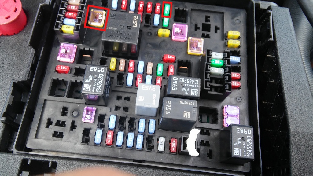

DO NOT DO THIS!
Update 20170707:
Launch will result in an immediate nose-dive. Yes, you will be able to exceed the 4000 RPM idle limit but some kind of fail-safe kicks in and immediately pulls timing.
Ever since I started bringing my new ZL1 to the drag strip it's been a trade-off between spinning the tires or bogging the motor. I managed to get my ETs down to 11.6 on stock tires by minimizing wheel slip. Then my new rims and drag radials finally arrived. I thought this would solve my problems... well, yes and no. It solved the wheel slip problem but I found that the ECM or one or more of the control subsystems would not allow me to get enough torque off the line to obtain a decent 60-ft time (under 2.0). With the DRs I'd need to launch and maintain a higher launch RPM - I figure between 4500-5000. The 4K RPM idle limit was imposed regardless of what drive mode I was in, even when I "disabled" Traction Control (TC) and Stability Control (SC) by holding down the SC button 5-8 secs. It also seemed to be robbing me of power when it bogged.
I had heard before that the "ABS Fuse Pull" worked on the 5th Gen Camaros to improve launch speed but the 5th Gen did not have the 4K RPM idle limit. Apparently, it did pull engine power at launch though. There's not a lot of detail describing exactly what this fuse pull disables or what subsystems are affected. It's even difficult to find the exact fuse numbers to pull. Then trz174 said in a post to one of my recent threads that he's done it on the 5th Gen and 6th Gen ZL1 and it appears to work the same. I decided to do some more digging... Some threads said that the (5th Gen) ZL1 no longer went into the familiar "nose dive" on launch. Here is a post that describes it well: "Line lock for a ZL1.... help please (Post #17)" 10-18-2015
Key phrase:
This is a great no-tune way to run DRs or slicks because it shuts off the ABS sensors and prevents the computer from reducing power when it hooks hard - the good kind of hook, not a dead hook. This is one reason why you see stock tune M6 ZL1s nose dive after a hard hook on DRs or slicks at about 40-50 ft out. The 8 second method does not shut down all the traction nannys, the ABS fuse pull does.
This is exactly what I want, it would seem. I went ahead and pulled both ABS fuses (F1 and f22) to document exactly what happens. The two annotated photos at the bottom show which fuses I pulled.
WARNING: I should warn anyone attempting this to proceed with caution. Be mindful that this will completely disable the Anti-lock Braking System (ABS). If you press to hard on the brakes you could loose traction and loose control of your vehicle. This also COMPLETELY DISABLES Stabilitrak (Stability Control - SC), Traction Control (TC), and the electronic Limited Slip Differential (eLSD). You will essentially be driving the car full-manual in every respect. I do not recommend this fuse pull for stock/street tires. It's way too easy to loose traction without the controls in place. In no case should this fuse pull be used while driving on public roadways.
I intend to try this during tonight's test-n-tune at a local drag strip... I'll let you know how it turns out.
--Cal
Observations with ABS fuses pulled:
Indicators after engine start:
1. In the tachometer display (left), the ((ABS)) & Stability Control Off Icon indicators are illuminated
2. In the speedometer display (right), the word "BRAKE" appears.
3. In the Driver Information Center (DIC):
- An "Information" dialog apears stating "Rear Axle System Off".
- A "Service" warning appears: "Service Rear Axle"
- Near the top, the "SC Off" icon appears.
- After a while the "SC Off" icon is replaced by a new icon ((P)) with wrench under it, apparently warning to service parking brake.
What stops working:
1. Idle RPM limit. While stopped, any throttle setting up to redline is possible. I only tested to about 5500 RPM.
2. Competitive Driving Modes. No competitive modes or features are available, including line-lock launch control, and no-lift shift. Only main drive modes can be selected. This does not appear to affect the default suspension settings for each drive mode.
3. Anti-lock Braking System. See warning above.
4. NPP does not open baffles while idling, even in "Track" drive mode. It does open up once you hammer the throttle, though.
- It's not possible to change "Engine Sound Management" in Infotainment "Settings". I went ahead and changed this to "Track" after replacing the fuses. Hopefully, once set it will retain these settings after the fuse pull. Didn't check this yet.
What still works:
1. Parking Brake
2. Drive Mode selection
3. Normal braking
4. No hesitation on acceleration.
Engine Compartment Fuse Block:
Pull and stow fuses: F1 and F22
Cover Diagram:
Fuses:

It went horribly wrong! Don't waste your time... While the fuse pull did remove the idle RPM limit, completely disabling SC and TC, the engine computer appears to have a failsafe that pulls timing immediately upon launch whenever it deems that there is too much clutch slip.
After 2 launches resulted in a complete nose dive I put the fuses back in. I was so thoroughly disappointed that, after a few more "normal" passes I quit and spectated for the rest of the night. I haven't been back to the track since then.
Pulling the fuses also seems to disable the engine sound management, preventing the baffles from opening on the dual-mode exhaust except for hard acceleration. It's like it stays in Touring mode.
I'll post the videos and notes later but I'm preparing to venture out again tonight. I gotta get seat time in the MT DRs.

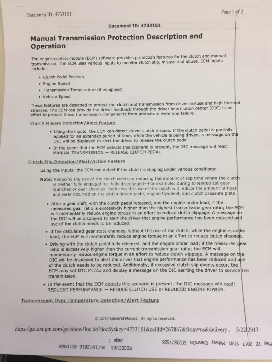

Sokay, I'll still have fun with it - just not as much fun at the drag strip as anticipated. I've still got a few tricks up my sleeve, though.
For example, next time I'll try a few passes without any burnout on the DR's. This should result in some wheel spin at launch. SOMETHING has to slip to get into the power band where the useful torque is available. If GM will not allow me to slip the clutch then I'm forced to sacrifice some rubber. My best time (11.6) on stock rubber was with moderate wheel spin at launch. Only problem there is that it's much more difficult to accurately and consistently control tire spin than clutch slippage. Too many variables - track condition, temp, humidity, throttle pressure... Still, it's worth a shot.
I'm convinced that the main problem with poor launch and low 60 ft / ETs in the 6th Gen ZL1 M6 is the always-on "Manual Transmission Protection" feature described in the document below. It cannot be disabled without a targeted engine tune.
I described my rationale in these two posts on another thread:
eLSD Wheel Slip % on M6 - post 151
eLSD Wheel Slip % on M6 - post 161
GM Doc ID 4733151 "Manual Transmission Protection Description and Operation"
(First posted by dcosta here)

Wheel spin off the line works best so far for mine with m/t Drs. but then again I don't have near the power you do. I don't get much seat time to experiment, but what I've figured works best for me is just slipping the tires through the water, then 3500 clutch dump. Doesn't seem to bog down there but still only a 1.9 60'
