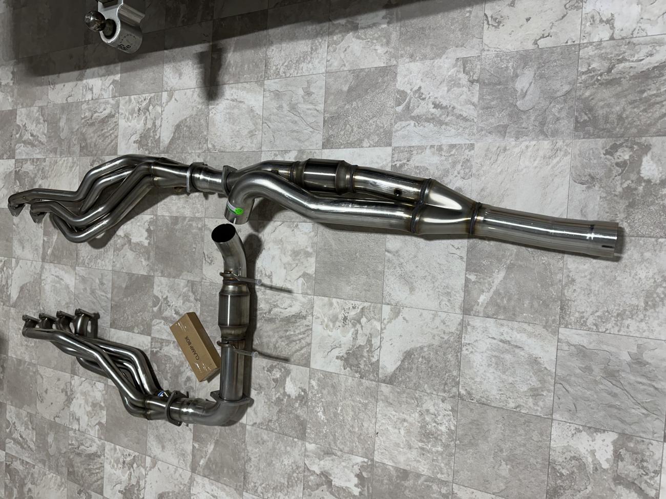

Hey buddy... THESE are the GESI Cats I have on my car now... the UHO versions. I tried running without them, but the smell, extra volume and rasp was enough to put them on. Just make sure you are getting the right ones for your power level...
