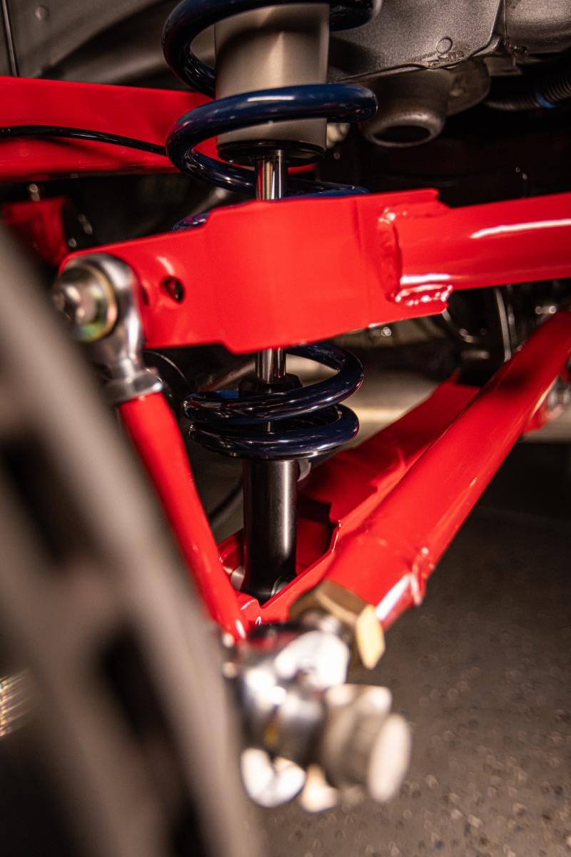

I don't think you can go wrong with a bunch of BMR stuff. Cradle lockout, cradle braces, upper rear control arm, trailing arms, toe rods, chassis brace, strut tower brace. I have them all.
Remember to get all replacement bolts for your alignment, as they are one-time-use.
These straightened out my rear squiggle problems.

This illustrates perfectly why the BMR arms provide much needed stiffness.
