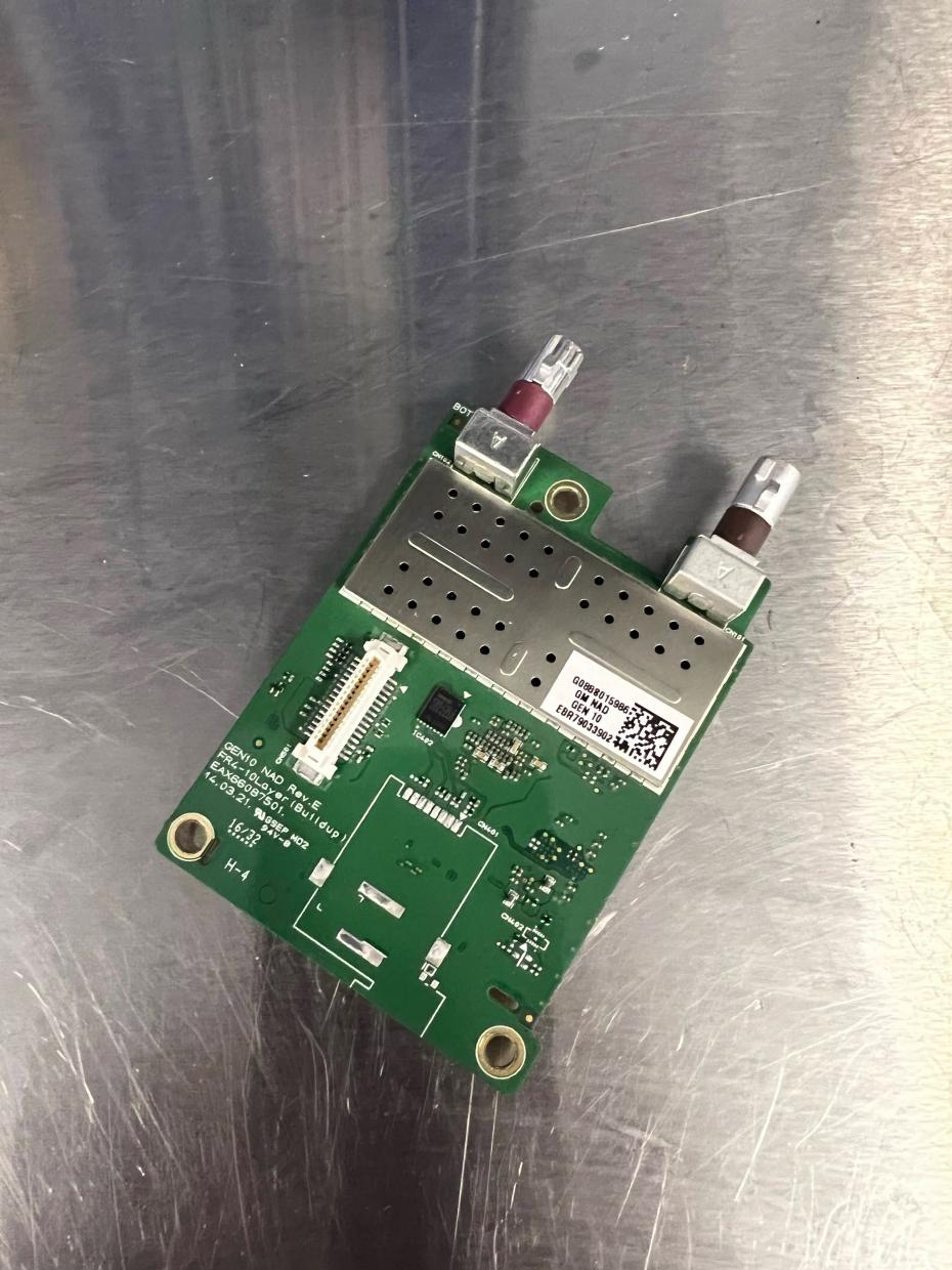

My OnStar module I believe died.. or a piece of it did. My compass does nothing now, my gauge cluster speed limit signs I used to get showing speed limit of the road I'm on (from the Nav) does nothing. I can no longer connect to my car from my phone app. Onstar buttons are all unlit. I don't care about the OnStar stuff itself but did like the gauge cluster stuff and connecting to my car from my phone. I bought another entire OnStar module but hadn't pulled it apart or attempted to install it as I'm sure the dealer would have to do something as well to program it to my car?
