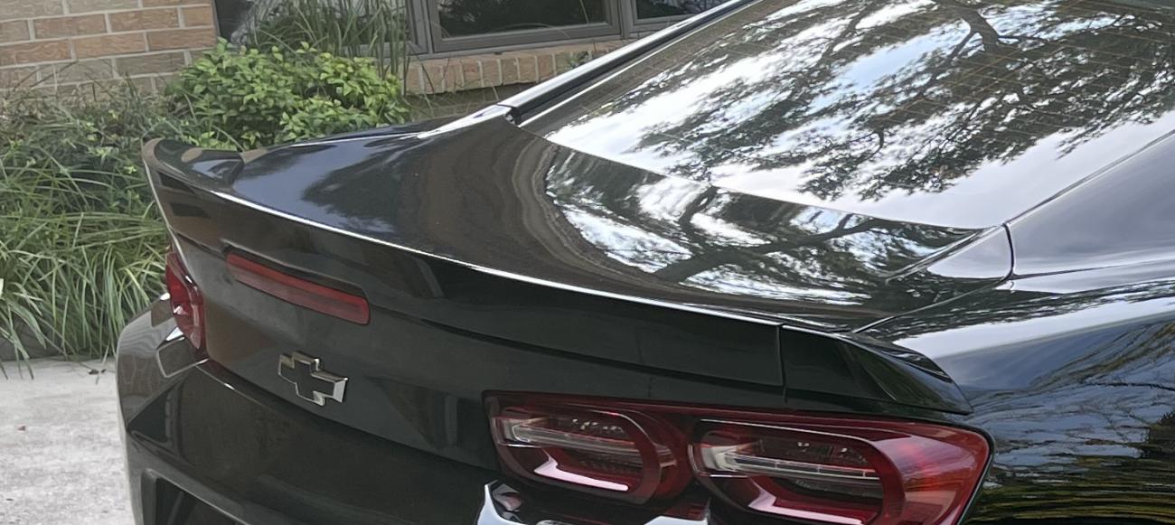

Does anyone know of what spoilers will match the holes of an RS spoiler? I wanted a ZL1 style but I didn't realize the hassle of the holes not matching :( idk if taking it to a shop to get the holes welded is in my budget rn. I can't seem to find any. Help!

Reread the post: the RS lip spoiler will match up with the blade option that you can find online.
If wanting a wing, The RS spoiler has extra holes and in different places that wouldn’t line up at all. You would need a basic non RS trunk where you could drill the holes you need, or find an SS trunk which would have the holes that would match the same placement as the ZL1 wing.
Maybe check on eBay to see who may have a trunk in your color that would work if you any to go that route.

An oe blade spoiler will match up with the holes from a RS or lip spoiler.
Camaros that were ordered with blade spoilers arrived at dealers with lip spoilers installed, then dealers swapped them out.
