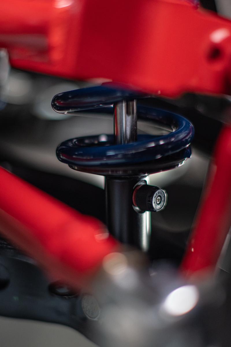

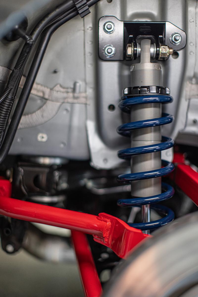

I would wait for the release of RideTech. Trust me.
- Fully serviceable
- Tunable
- Full spectrum of spring rates available for your choosing
- Owned by Fox Shocks
That checks off every single box that a person could want or need for a track focused supercar like the ZL1 1LE

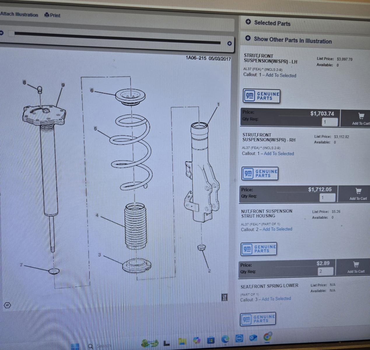

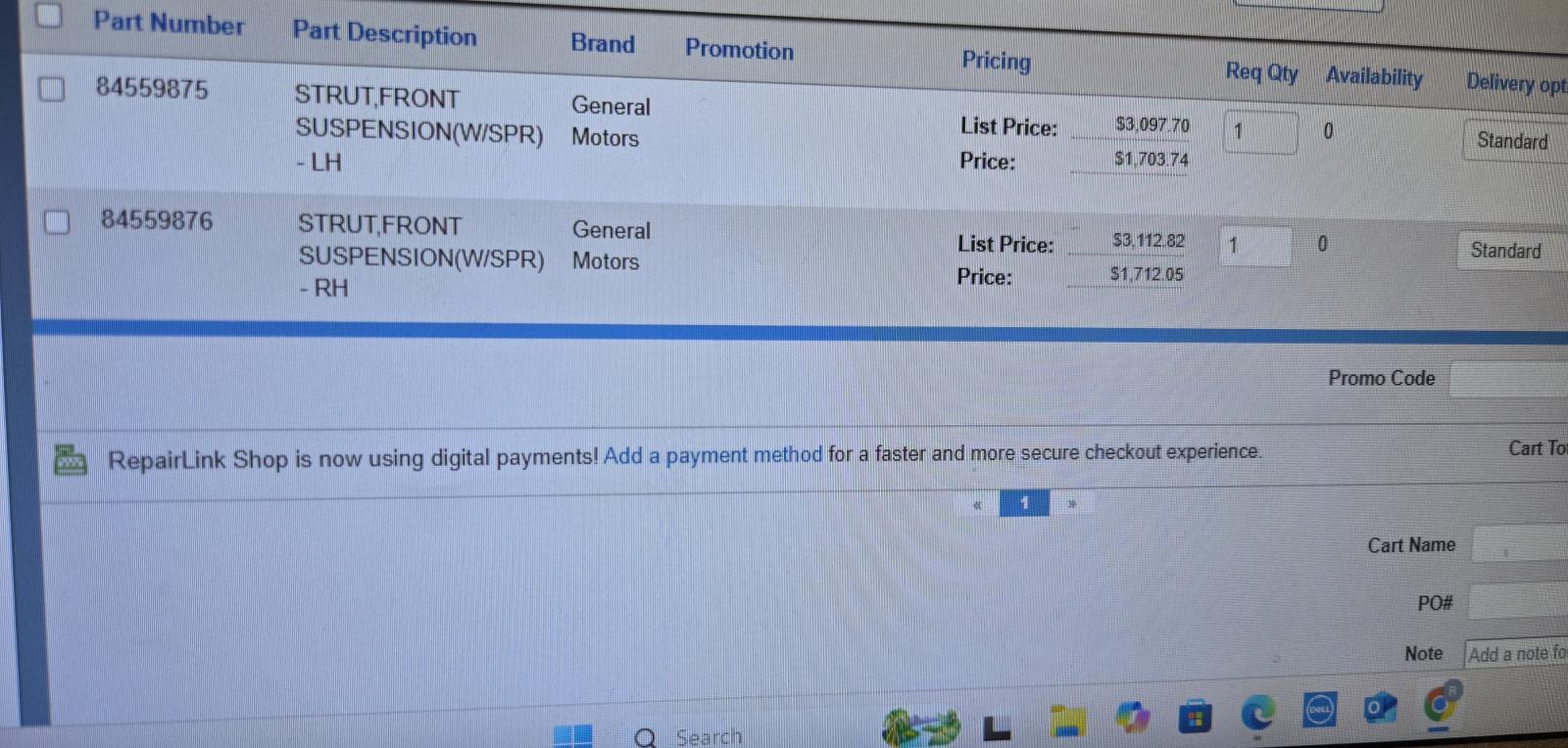

$1700 list for each one. I'm glad i dont have that suspension.

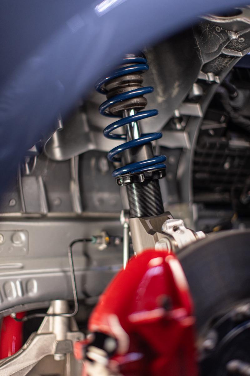

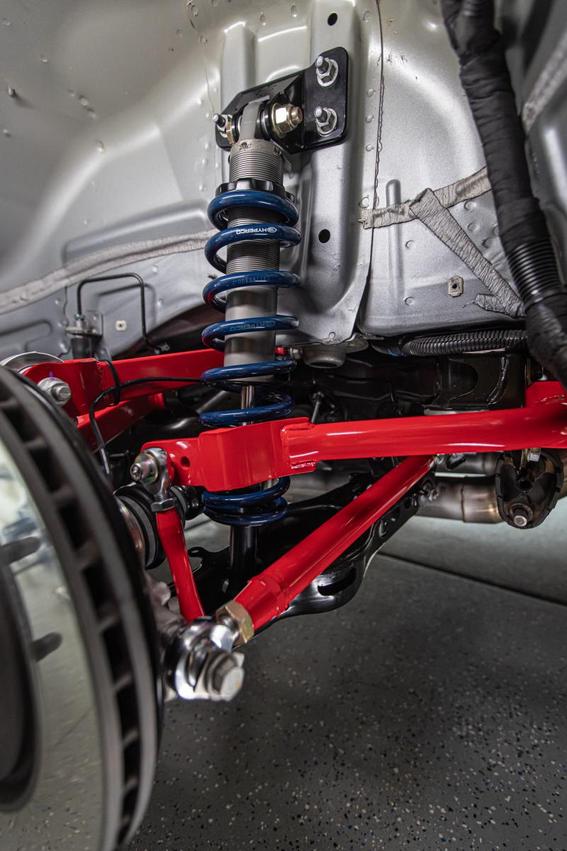

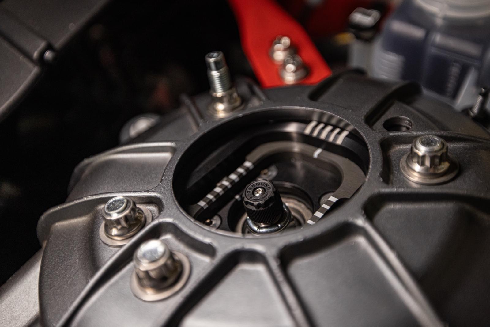

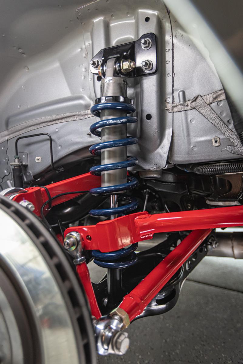

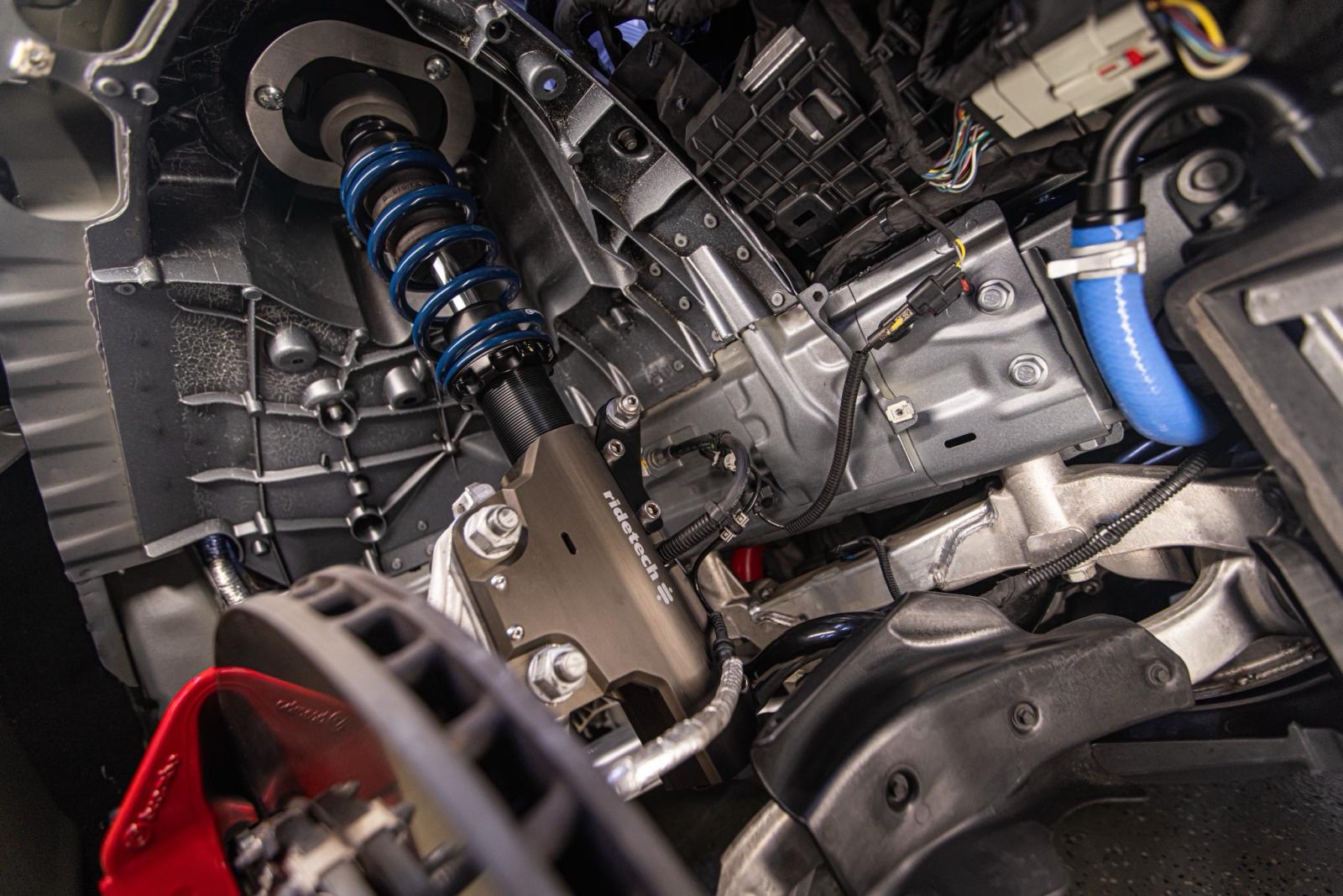

- Fully serviceable
- Tunable

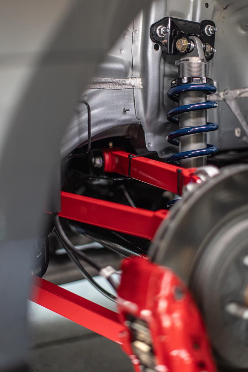

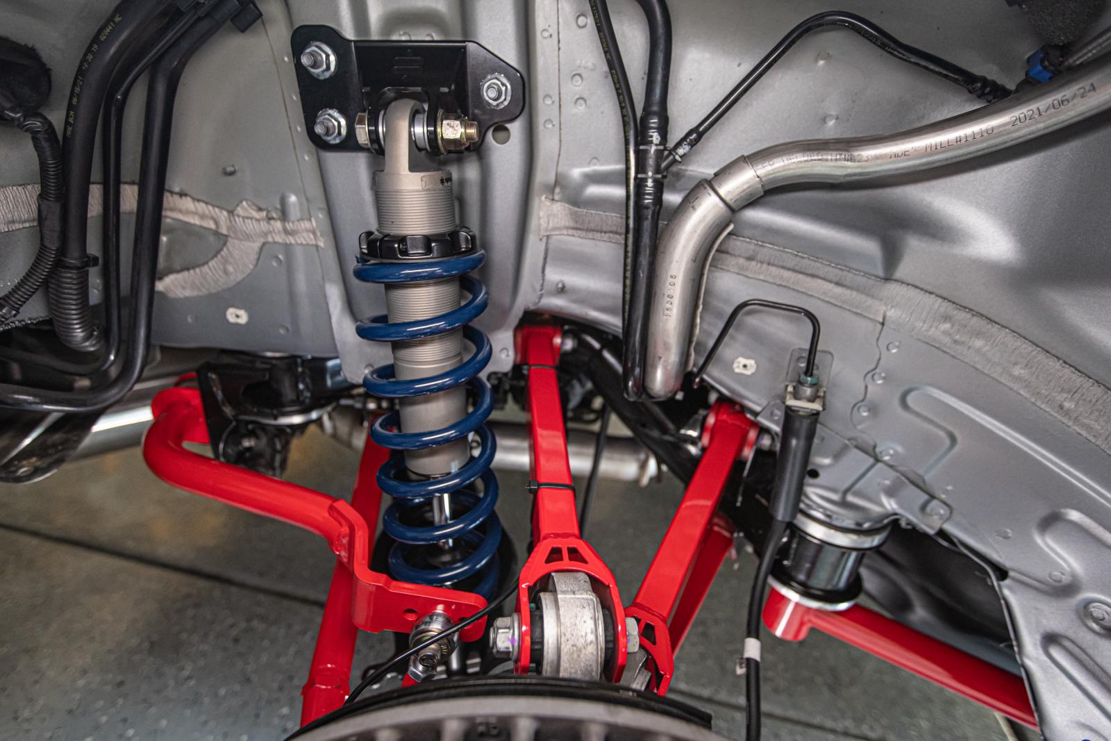

Well said ROB... All of the reasons why I am excited to be helping Ridetech Test & Tune for the ZL1 1LE on my car. They are currently installed front and back, total weight savings is around 8lbs when paired with the BMR rear coil-over lower control arms (those go on this week)... should have some feedback to share with everyone next month (currently tied up with several projects)
But like Rob mentioned.... they are looking very promising.
Oh, and dont forget lifetime warranty... !!!

Originally Posted by ZL1_1LE View Post
Where are you testing them at? Do you plan on keeping them or going back to your stock 1LE multimatic?
Here in San Diego... I dont plan on going back to the DSSV, will sell them later on... I have had 2 fail so far, and replaced them with used ones because they are so damn expensive.
We may test a few other spring rates so I dont expect to have formal feedback until early next year.... I will also be doing an awesome group buy when the time comes.
MAN those look SO nice!
Looking forward to seeing your testing on them. This is exactly what the 1LE's should have had from the jump. It's nice to see one of the two major shock companies stepping forward and making an application specific shock setup for these cars. You can never go wrong with Fox or King.
