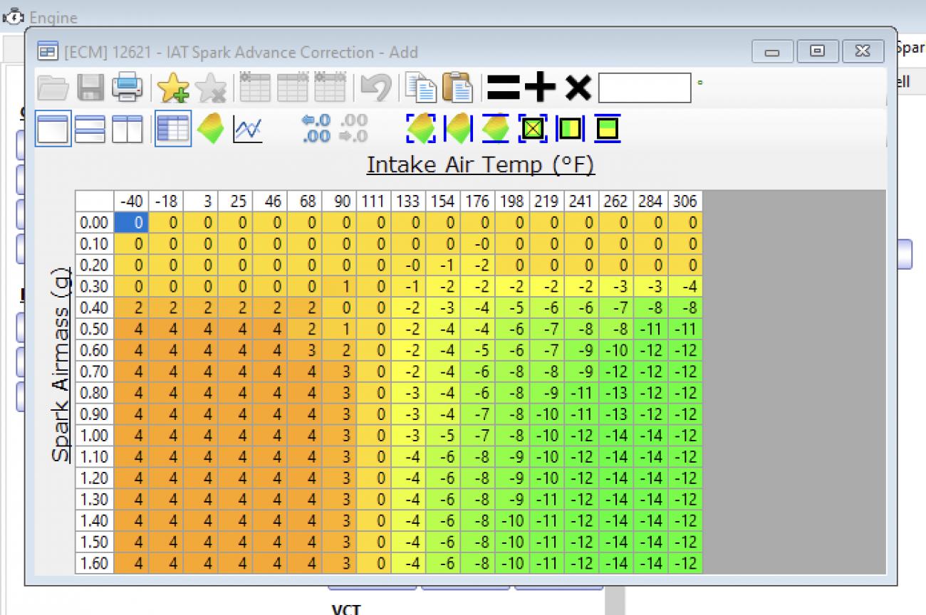

So which is better to monitor IAT.2 or 3, which temp actually pulls timing when it’s over 140*?
I monitor both. Tracking / logging IAT.2 will give you the real world data on effectiveness of your HX cooling system. Like in your case, before and after cooling / performance mods.
I also track / log IAT.3's because thats the number used in your IAT vs. Timing table... and although it is a calculated number, it is the number that will determine your timing or lack their of.
The stock tune starts to pull timing at 133F.
I know many tuners will raise that ceiling, especially when the car is using E85. If your car is tuned, I'd check that table to see what it is for you, and that way you can track it for awareness purposes.
That said, it's ok if your IAT.3's are higher than that... but if you were racing then you would at least know where you are at in the cooling process. Would love for one of our tuners to chime in to add or subtract from my current understanding.
Which is why I often say that the Banks iDash is the BEST first mod for the ZL1, because you get that critical data, along with a dozen other amazing features.

It's my understanding that IAT.2's come from the TMAP sensor at the back of the drivers side blower (post intercooler bricks) Which is why those numbers will / should decrease after a pull thanks to higher air velocity, and reduced heat soak from the intake runners / blower. Air is moving too fast to heat up. (this assumes your HX system is working properly) The only problem that I am aware of is that the OEM sensor is very slow acting, and does not accurately capture spikes in temp changes.
Which is why I am adding a new RIFE IAT sensor on the passenger side, as well as an IAT temp sensor on the hot side of the blower. I am not certain, but I believe I'll be the first. Doing this to better support future testing and system design. Stay tuned for more on this one!
MAT's are calculated as you noted, from RPM, Speed, ECT, EOT, Ambient Temps, Boost Pressure, etc...
I guess the logic is that it would be too risky to base your timing curve on the actual IAT.2 sensor data, and should there be an issue with the sensor the car could suffer. It seems much safer to base the timing table on a calculated number that ignores the spikes in IAT.2 if they did exist. The problem for us, is that number is heavily biased for safety, not power efficiency.
I suppose thats why many tuners will raise the IAT.3 threshold for timing being pulled?
That said, do you ever adjust that table? If so, can you share your methodology?

Just worth noting- this table doesn't start pulling timing at 133. That is how everyone refers to it, and it may just be semantics, but it's actually pulling timing at anything over 111. It interpolates the timing values between the temperature points. So for example, at WOT and 122F, you're seeing a -2deg timing adjustment. Maybe everyone already understands this, but I wanted to post just in case.
Hey Rob... that is insightful for sure. I did not understand it that way!
I'll have ti check my past logs for this.
