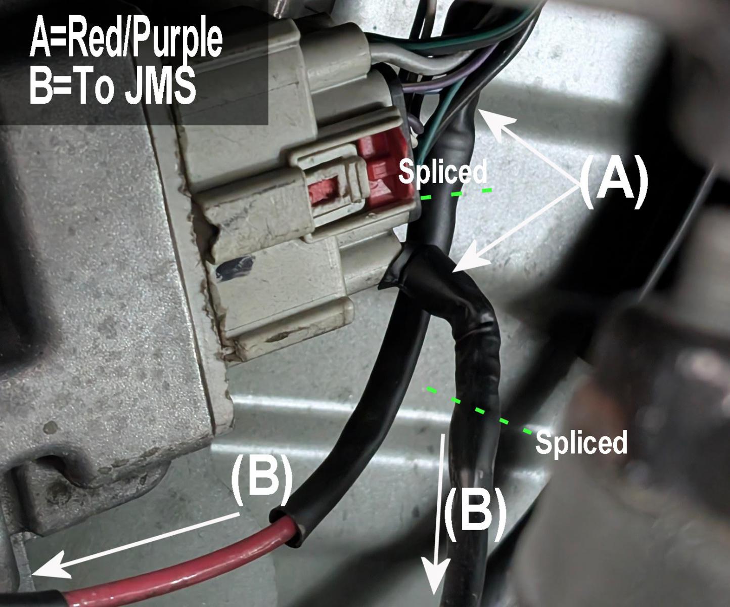

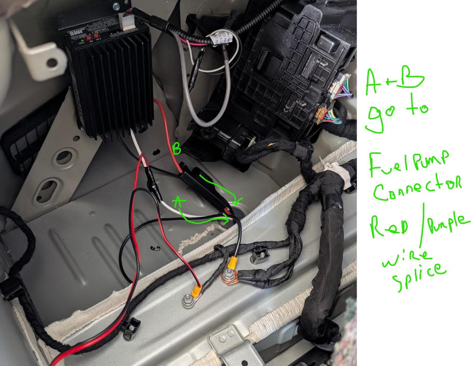

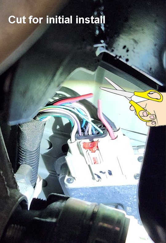

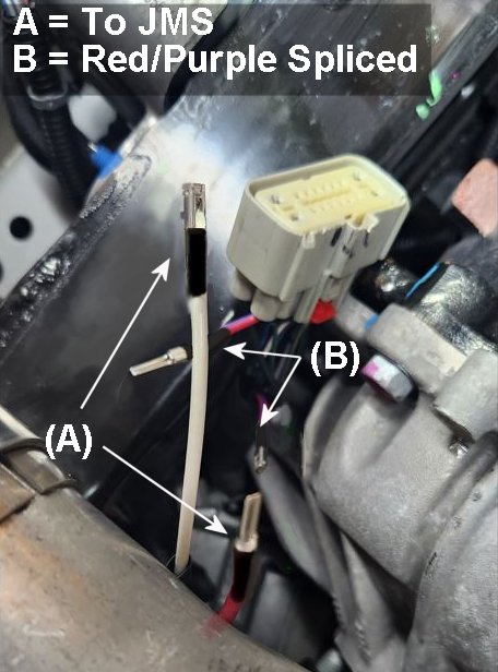

Quick questions, I think the answer is YES, but would appreciate confirmation! So, now that I have the drop in Katech Dual Fuel pump, I no longer need the JMS FuelMax installed, and I want to remove all of it. My question is: Can I simply remove all JMS stuff, but connect the RED wire and the WHITE wire from the JMS device together in the trunk (those go to the factory Red/Purple wire I spliced at the FPCM), and that will basically reconnect the factor Red/Purple where I made the splice? I will reconnect under the car at a later time, but I sprained my wrist, and can't really work up above the axle comfortably at the moment. I added a few photos for reference. Thanks in advance for your help!

NO, remove the FuelMax.. you do not want to be running it in conjunction with the dual fuel pump setup as the controller runs directly off the battery and not the FPDCM, so there will be a discrepancy in voltage and cause the secondary pump to have a different DC and ultimately fuel flow than the primary, and you don't want any of that drama.
To answer you original question, yes, reversing the wire at the connection point on the FPDCM will restore it back to factory. The exact colors you mentioned.
