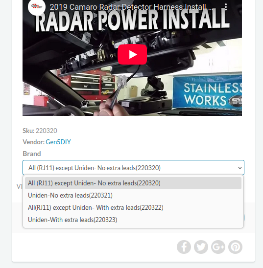

You can opt for "extra leads" that can power your dash cam when ordering the radar detector harness, see below. Their product description also mentions this option.
