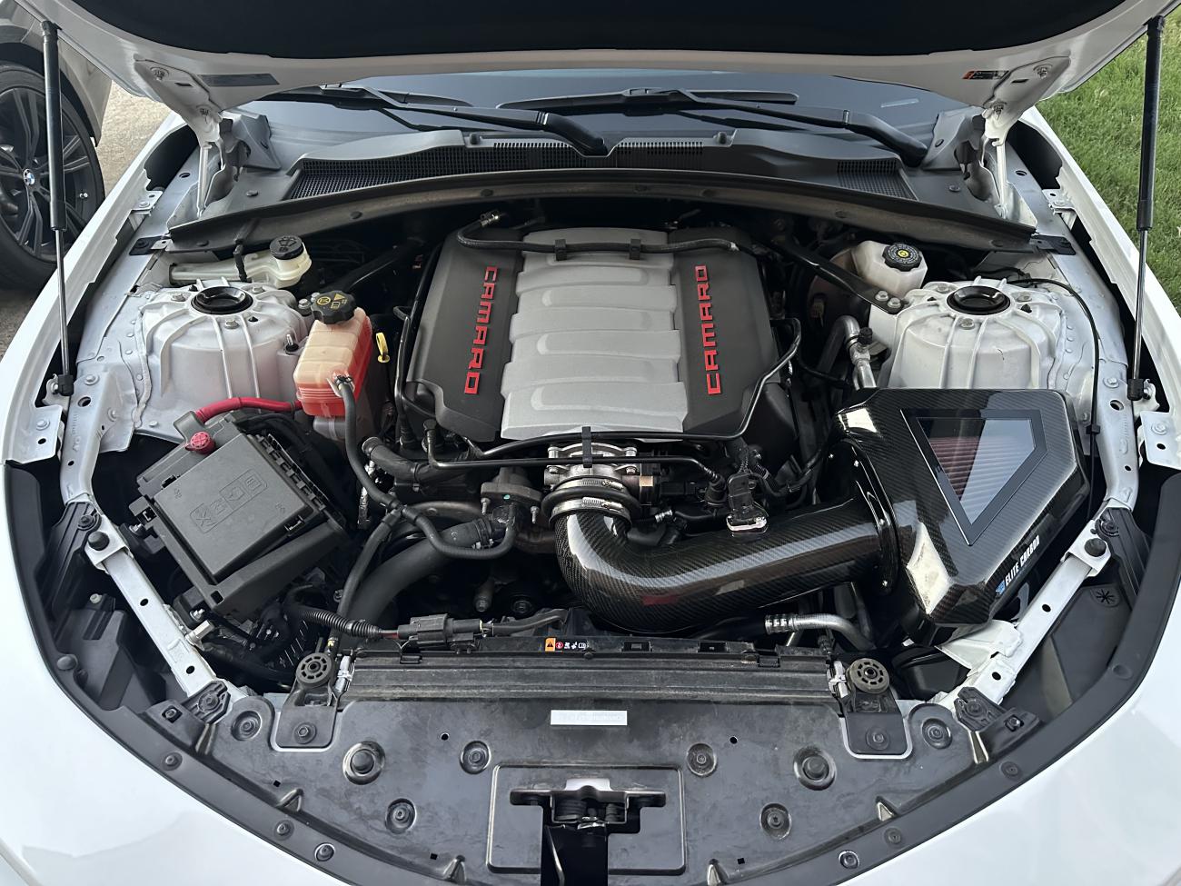

Old 04-28-2025, 04:00 PM   #10
Bumbleboy92
Long hauler
Bumbleboy92's Avatar
Drives: 2022 Camaro 2SS 1LE
Location: Houston, TX
Posts: 2,005
(I chalk it up to the previous owner buying it )

Originally Posted by Bumbleboy92 View Post
Attachment 1163503
Attachment 1163502
I actually had this one on my H/C/FBO/e85 1LE, and I love the way it looks (and got a lot of compliments, because it's different than the typical open filter look). I swapped to JLT 5" (required re-tune) only because it's easier to maintain after track days (which suck up a lot of insects and twigs out here in the desert).
Anyways, I gained a whopping 3rwhp and 4rwtq I bet most of that was due to also having slightly higher ethanol content. I was 65% with the CAI, and around 75% when I re-tuned with JLT.
But I agree with the previous poster. The CAI debates are laughable, the stock airbox is in no way a restriction and the rotofab cultists are cringe. Keep in mind these dyno comparisons are with no heat soak and open hood, and if they show any good gains it's likley because of the tune they didn't mention.
