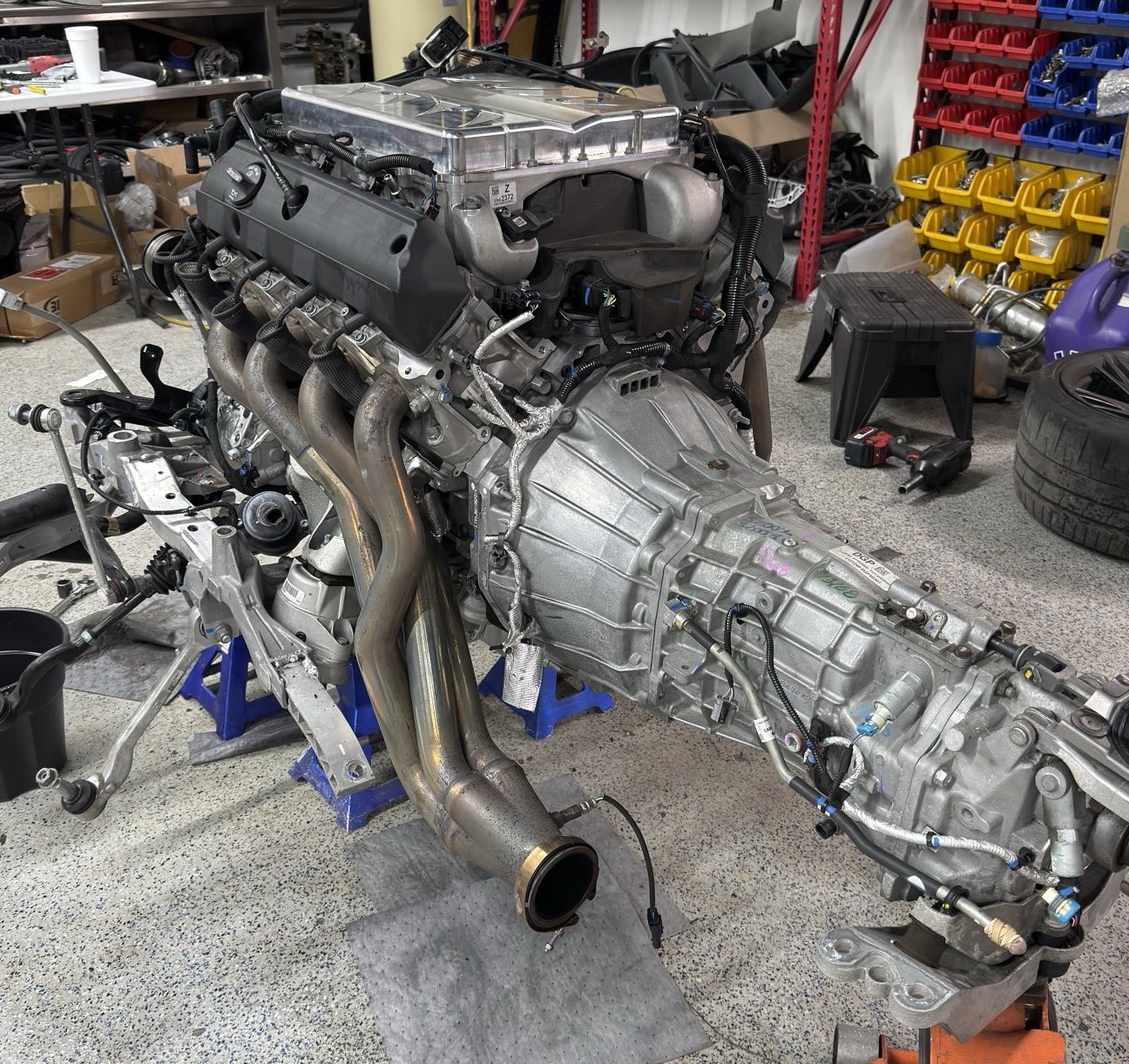

After tackling the cam install on my 2022 ZL1 1LE 6MT this past weekend, I wanted to share some key takeaways—both for those tackling a similar project and as a personal reference for the next time I lend a hand. I'll keep it concise but am happy to elaborate if anyone has questions.

Lessons Learned
1. The GM Service Manual is Worth It
There are plenty of threads and YouTube videos, but nothing beats the GM Service Manual. A three-day subscription costs $22 (ACDelcoTDS) and would have saved me hours of Googling.
2. Inventory Everything Before You Start
Avoid delays by ensuring you have all necessary parts and fluids (water pump gaskets, distilled water, transmission fluid, brake fluid, A/C compressor belt). The factory belt is stretch-fit and a pain to reinstall, so plan accordingly.
3. Take More Pictures Than You Think You Need
Some steps seem obvious in the moment, but three days later, you’ll wish you had that one reference photo.
4. Label and Bag Everything
Despite my best efforts, two bolts had no home until the very end. Avoid this by bagging and tagging every part.
5. Dropping the Engine Cradle is Easier Than You Think
If you have access to a lift, drop the cradle. It’s intimidating at first, but straightforward. Two extra hands help, and if I had to do it again, I could probably drop everything in about six hours.
6. Keep the Motor and Trans Together
The GM Service Manual suggests separating them, but since I dropped everything as one unit, some steps were unnecessary.
7. Mark Your Jack Stands
If rolling the cradle isn’t an option, mark the jack stands and contact points to ease re-installation. My driver’s side lined up perfectly; the passenger side was off by about an inch.
8. Install a Remote Bleeder if You Have a 6MT
I ended up using a MityVac handheld vacuum pump, which was easy, but having a remote bleeder would provide another option I didn't even consider.
9. Get a DMS Supercharger Bleeder Adapter
I didn’t even know this existed. I used a Harbor Freight funnel and a 3/8" socket to depress the valve while running the coolant pump manually.
10. The Slave Cylinder Retaining Pin Goes in From the Side
I lost an hour figuring out that the pin doesn’t go straight up from the bottom.
11. Don’t Throw Away Any Bolts Until You’re Done
I found myself digging through the trash looking for three missing engine cradle bolts. Lesson learned...
12. Valve Locks & Wear Caps Matter
  • The TSP valve spring kit comes with 16 hardened valve locks—use these only on the eight intake valves. The exhaust valves retain the factory GM locks.
  • The intake valves have wear caps—they can come loose and get lost in a hot tank wash. A magnet helped me recover a missing cap.
13. Secure the Steering Wheel
If the steering shaft disconnects, make sure the wheel doesn’t spin. Mine did, and now I’m troubleshooting power steering and ESC issues.
14. BMR Motor Mounts Require Adjustments
I torqued everything down, but later had to loosen the mounts significantly to align the transmission crossmember.
15. Preload the Oil Pump
Before fully filling the engine with oil, make sure to preload the oil pump after filling the filter.
16. Wideband Setup in HP Tuners Requires a Specific Process
This video explains how to add the wideband channel, but I had to:
  • Ensure the car was running
  • Let the wideband pass the "heat" stage
  • Re-poll for parameters
  • Add WB EQ Ratio 1 (SAE)
17. Load the Correct Tune
VCM Editor stores the last edited tune by default. This pains me to admit... but I accidentally reloaded the same tune, leading to 20+ error codes.
18. Read Ted’s Instructions Carefully
I skimmed past the crank re-learn procedure, leading to unnecessary troubleshooting. Once I followed it correctly, all DTCs were cleared.
In the end, the build had a few sticking points, a couple of smashed fingers, and plenty of lessons learned—but the result is a very choppy ZLE.
Attachment 1160891
Attachment 1160893
Attachment 1160894
Attachment 1160895
Attachment 1160892
