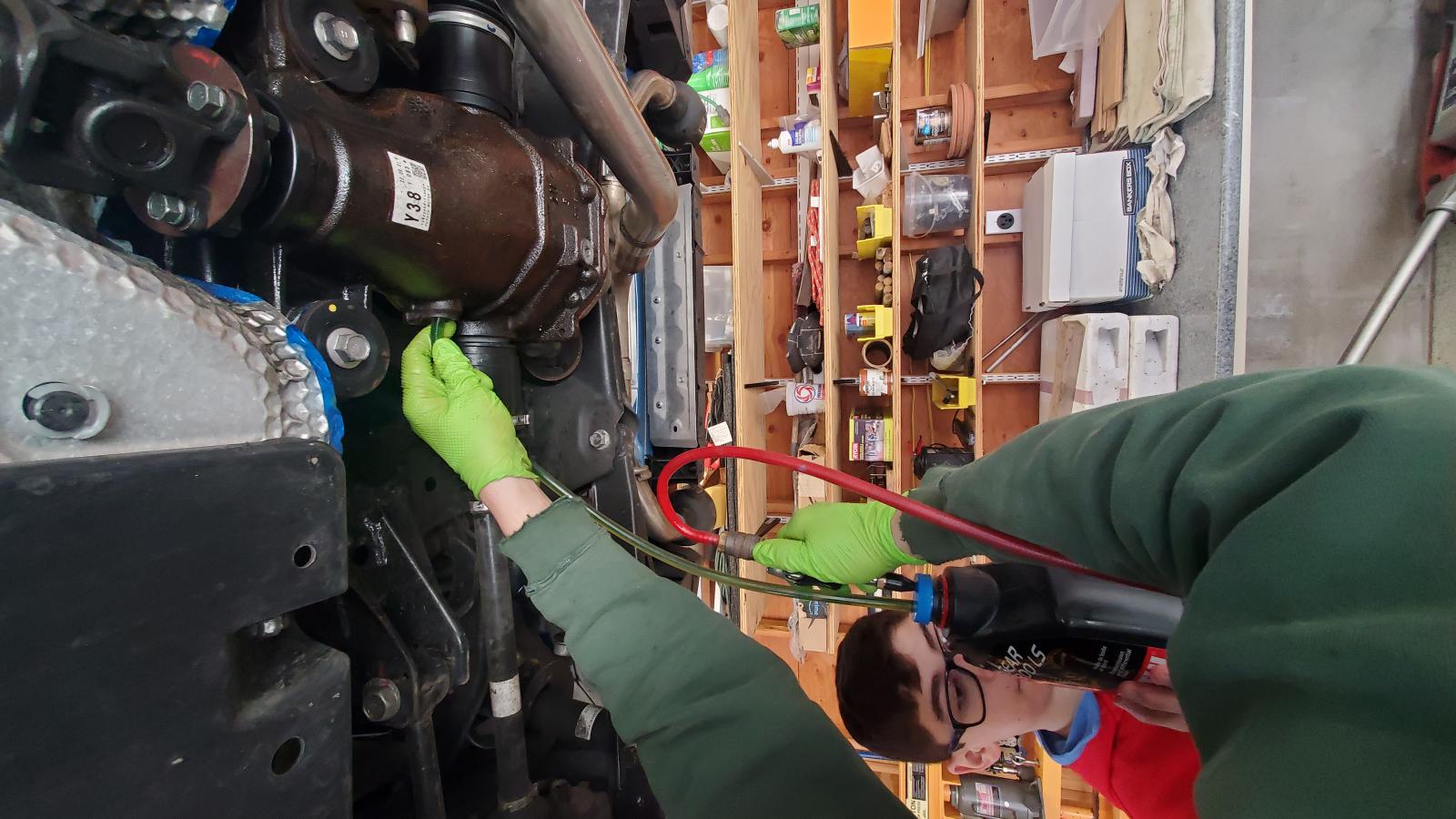

Here's what I did on last Diff oil change:
1. Modified cap to fit hose into bottom of gear oil bottle and enough to reach diff housing
2. On same small, drill small hole to fit end of air compressor blow gun nozzle.
3. Set air pressure into low low end of scale, prob in 2psi range.
Slow add air into bottle, bottle will inflate a bit and will soon start to push gear oi out of the hose. Rinse repeat with both bottles. This method works best when gear oil is not frozen cold!
