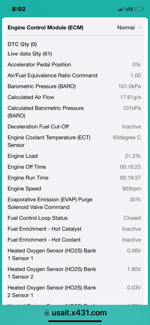

Hi I have a 2020 Camaro SS fbo. It’s been about 7000 miles since bolt on and tune no problems. I noticed my exhaust was smelling different and on cold start up the idle surges and almost stalls hunting. Will also pop a little on the high way at 3000 rpm and let off the throttle. Put it on the scanner and no codes. Checked some sensors (not a mechanic so some stuff is foreign to me) but I did notice that my O2 sensor 1 on both banks was reading .05 volts super lean and my O2 sensor 2 in both banks was reading 1.9 volts super rich. No miss fires ? It was in closed loop and I know that O2 sensor doesn’t really tell the ECM to do much just the #1 sensor before the cats. Do you think I have bad cats? Anything else I should look at on scanner? Any help would be appreciated. Thank you

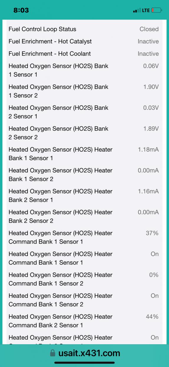

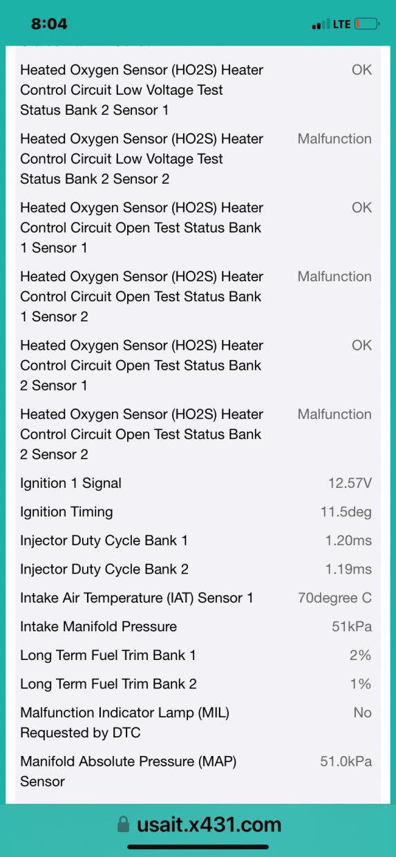

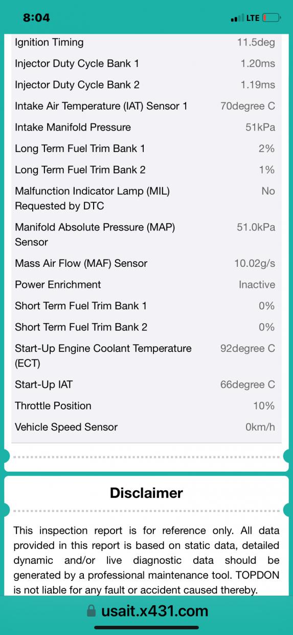

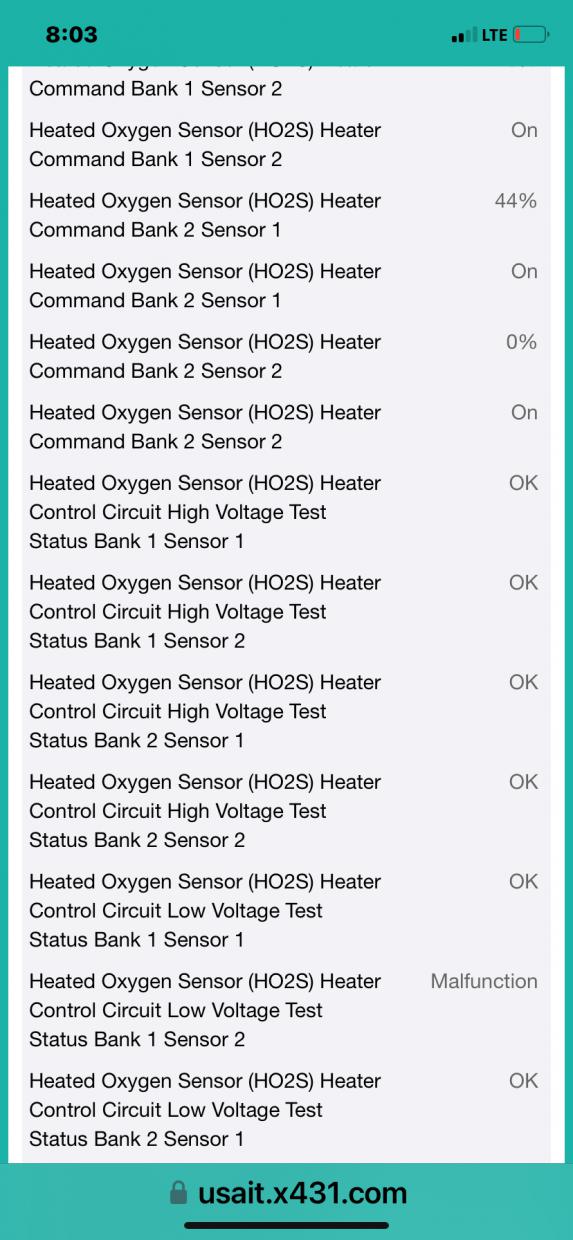

Scanner results

Looks like you have Voltage out of range and no current flowing on both post-cat (S2) sensors. Are you sure they are connected?

Fuel trims don't look unusual in that snapshot but its really the whole range to look at. Make sure you don't have fuel trims that are exceeding + or - 10-12% at any RPM range or where bank 1 or bank 2 are vastly different.
IF your cat is clogged, it would seem down on power and the header would get very hot and possibly glow when it dark out side. If you have a laser temp gun you could check the temps of each header primary and make sure there are not any large differences cylinder to cylinder.
I'm assuming you checked your plugs and wires already? Make sure the plugs are good and no burnt or loose plug wires.

Update the #2 sensors after cats are installed but the wiring is cut clean. I’m assuming the tuner did that and did it for a reason so I guess that explains the bad readings but now that I’m looking at the #1 sensors (that are wired in)there is practically no voltage should be about .45 volts and the amps should not be milliamperes. Do you think I have bad O2 #1 sensors or am I just chasing my tail. Thanks for the help

The front sensors should be switching from very low voltage to high voltage. (.100 - .900 or so).
If they are not switching then you potentially have bad sensor(s) or wiring. But its also possible if they are stuck at a low voltage the car is actually tunning lean and the cause is somewhere else. But your snapshots would have shows very positive fuel trims if the front O2 sensors were stuck showing lean.
I'd look up some videos on YouTube about how to use your scan tool to check for bad O2 sensors.
