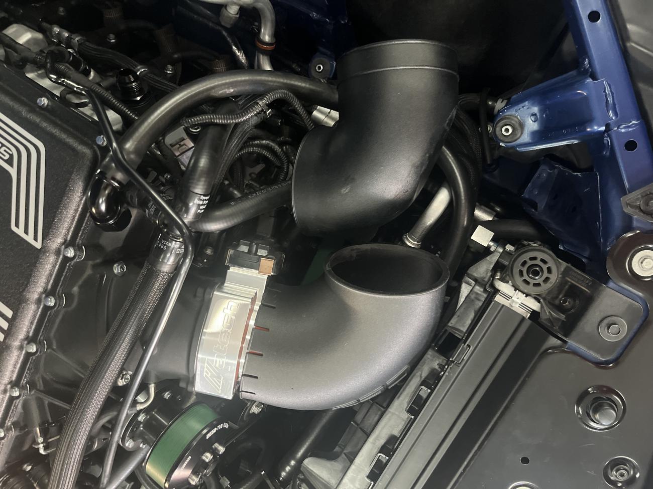

Clegg Performance Designs Intake Elbow
Installed my CPD intake elbow earlier for a 103 inlet. Jey has a few different options and actually made this one for me since his other version wouldn’t work that’s made for a 112/120 inlet. I think this will be a good middle ground for where the car is at power wise. Doesn’t need a 112/120 inlet or TB but could use something bigger tube diameter wise than the pinched down big gulp elbow.

The inlet on my Eddie is different from your 1.7, and I do not see how I could fit your inlet. Plus mine is 6" to 5" to 4.4".
It should work. I have a 2650 with a 103mm inlet. He has four different options now since making this one for me.

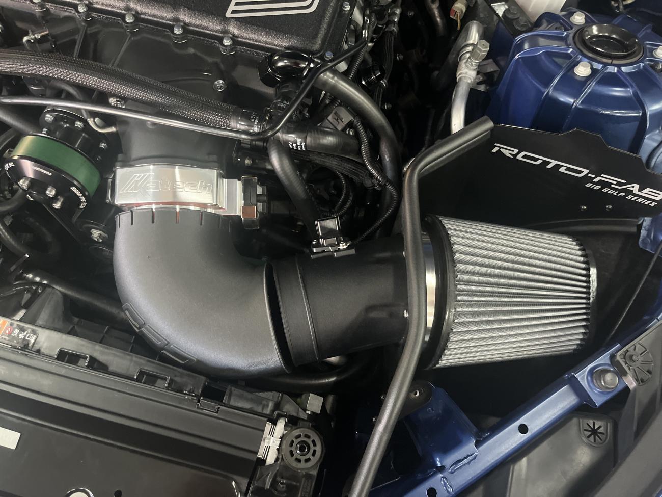

He has a completely custom fabbed CAI for it now, so you likely won't get any data on the Clegg elbow. Imo it didn't gain much...not worth chaning. If you want to gain from the Big Gulp then you need a true 5" id tube from the filter to the TB.
