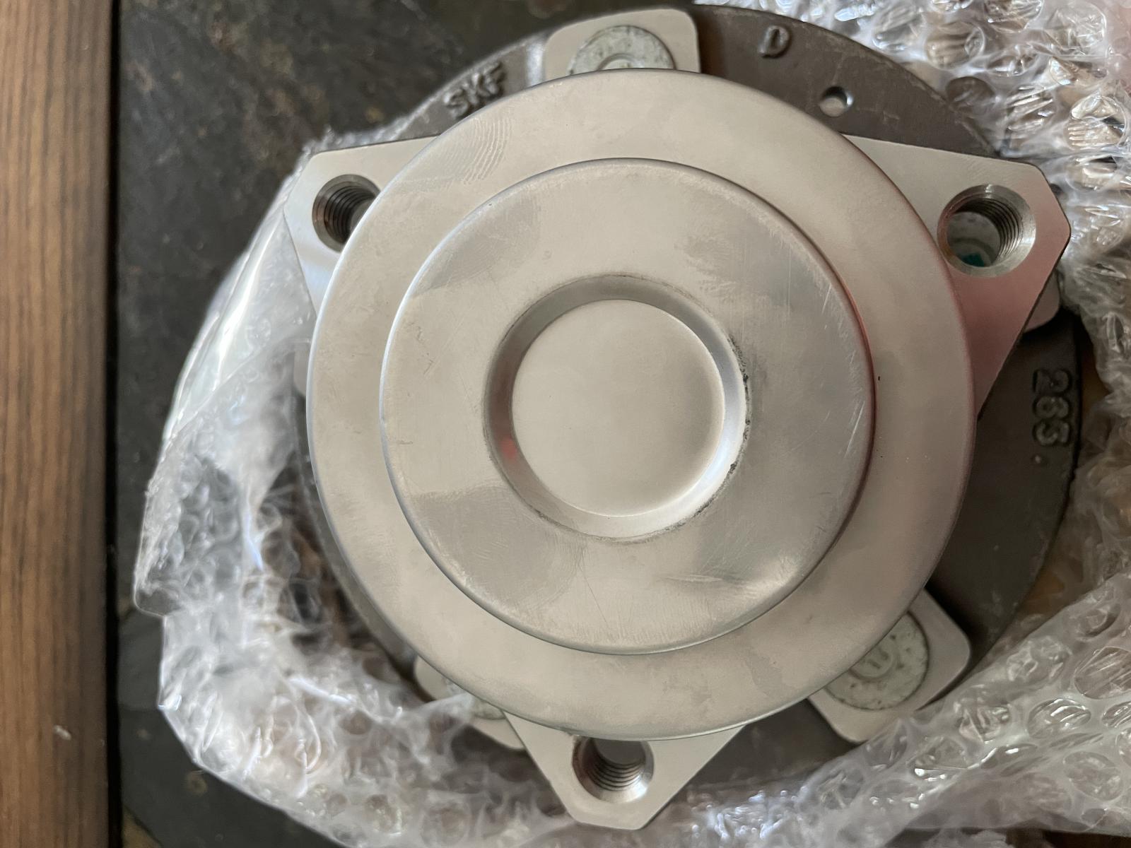

Hey everyone,
Getting ready to replace the front wheel bearings and hub on my 2017 SS. They arrived with slight dents/gouges on the back. Trying to decide if I should go through the hassle of exchanging them. Would this affect performance or safety at all?

It's just a dust cover. It will be fine.

Probably should have listened to you. But I reached out to the dealer I bought them from and asked them what they thought. They said they would send me new ones and to send the first ones back. Well I just got the new ones and feel like they are making much more noise than the others (don't think they even made noise). I can't check the first ones because I already sent them back.
Am I crazy or is this not right? Every video I've watched on the subject, the bearings are pretty much silent.

Sounds like a new bearing.
Swapped mine on my SS last year. I ordered Timken, because OEM wasn't available on rockauto. Paid like 110$ for 1x.
They made a similar noise.
