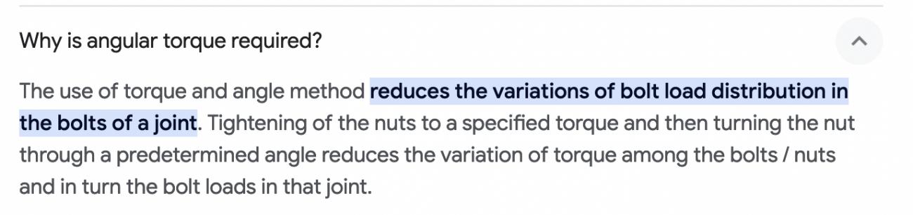

You are correct... first pass 48ft/lbs... second pass 90 degree.
The second pass has no torque value. It is an angle value. I know it seems silly, but that's the spec.
