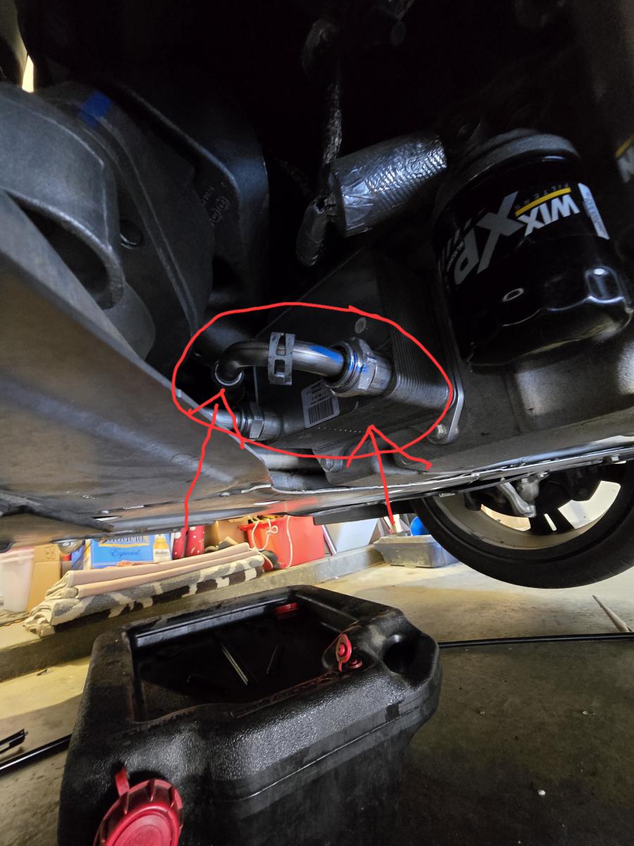

So I noticed oil residue under my car and looking under the car it looks like it's coming from the oil cooler. So I drained the oil to try to tackle this problem. It looked like it was coming from the rubber hose going to the oil cooler. So I took the hose clamp off and I started to unscrew the fitting closest to the oil filter when I noticed a liquid starting to come out that wasn't oil. It almost looked like coolant. I took a picture of what I'm referring to. Does coolant run through this? I thought this was the oil cooler?

Yes, oil stays in the cooler, coolant runs through those pipes into the cooler. The oil pans are known to leak, check the tightness of the bolts maybe, that's where mine leaked.

ok so if theres oil on the rubber hose circled in the picture, that oil must be coming from somewhere else correct?

I'd say the best approach might be to clean it all really well and then let it run, see where it drips from. Oil can get blown all around and makes it hard to find the source.

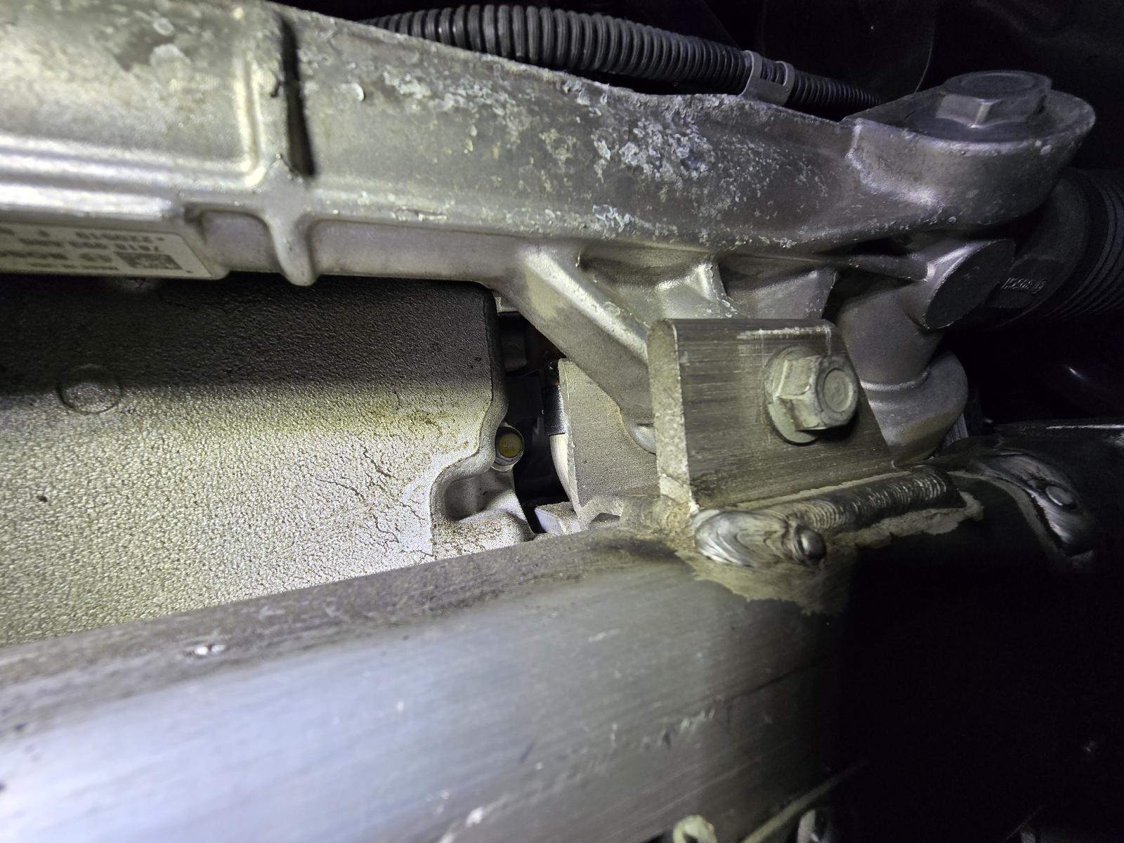

Well I'm hoping I found my leak. It's hard to see but oil was puddles o. The end of this bolt toward the driver front side of the motor. And driver side is where I noticed the oil. Multiple bolts were loose but not finger tight like some have said. Hopefully this is my issue

Nice, I had bolts loose on both sides on mine, hopefully you can snug them up and take care of the leak.
