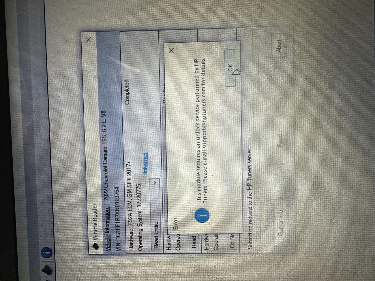

I got my Tcm unlocked by hptuners last week and installed it today. When I went to ready the file I got this message is this normal?

No, I’d reach out to HP Tuners. It’s normal to give you a generic stock TCM tune if you try to read it (even if you’ve uploaded a tune, you will still only get the stock one if you try to read it), but that message doesn’t look right.

Is there like a step by step on how to do this? I didn’t get no steps from hptuners other than the tcm was unlocked and mailed back

There is a process in vcm scanner to replace a tcm. Don’t remember the specifics but you might want to look into that.

Yea I seen that I’m suppose to get a replace tcm option but I don’t get that button

Is this the same process for the Camaro? But this is for new tcms I kept my old one and just had it unlocked

That is the process. Are you on the latest beta?

No I have the regular hptuners software have been for like a year. When I get home I’ll try to download the latest beta

Pretty sure you need the latest beta.

Ok got it working lol just needed the beta version I guess ��
