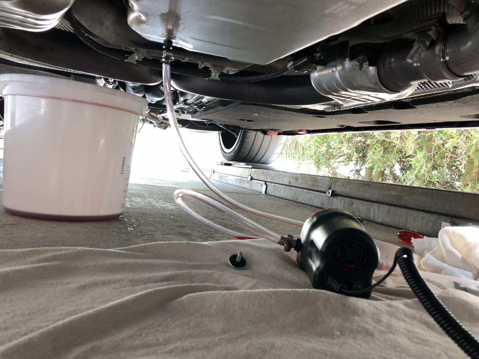

What tool works to fill the A10? Can I use a slippery pete pump through the level check port?

I use this:
https://www.amazon.com/gp/product/B0...0?ie=UTF8&th=1
I've used it thru both the level check port in the pan and the hole at the driver's side of the case (near the shift cable mounting).

I use this:
I was not aware there was any where else to fill besides the level check port.

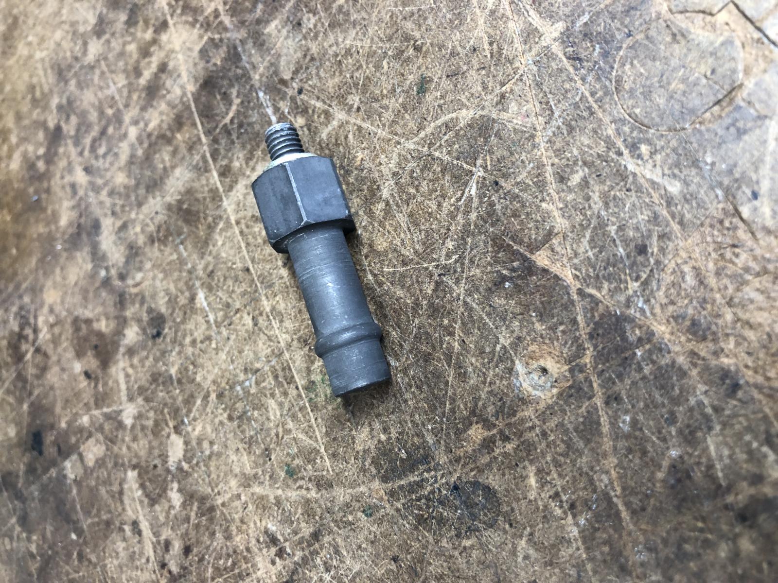

It's difficult to remove the plug. I cut a piece of an 8mm allen wrench to engage the plug then use an 8mm ratchet wrench to easily turn.

Where did you get this adapter?
Slurpee is offline   Reply With Quote
Old 05-07-2024, 03:48 PM   #8
cdb95z28
cdb95z28's Avatar
Join Date: Mar 2008
Location: Johnstown, PA
Posts: 3,815
I don't remember where I got mine but google GM 10 speed fill adapter, you'll have lots of choices.
