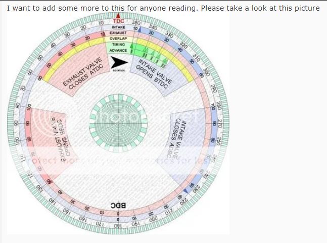

Mine's now at 370/175. 370 makes sense, but the 175... not so much. Here's a graphic to study on rainy days.
