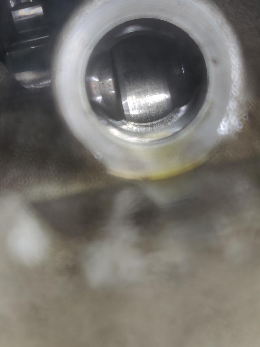

So I heard what I was hoping was a belt tensioner but after further inspection with a stethoscope, I confirmed it was the classic cam lobe chirp noise. Before I pulled the motor and tore it down, I could tell with the stethoscope it was somewhere around the #4 cylinder. So I got the engine pulled and pulled the passenger side head (I couldn't pull the drivers because I don't have a 13mm hex head socket and didn't want to risk using my 14mm hex head socket for the driver's special head bolt). #4 definitely is the worst, and by a good bit compared to the others although all of them still didn't look great but more ok.

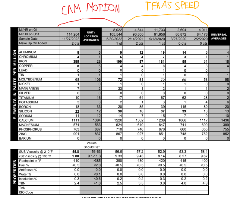

So I have only had this Cam Motion cam in for less than 15k miles. Its a 226/238-114-.630/620 (XA226/350-XA238/345-14+3) and I believe it is on a stock/OEM 5150 core. Before I had a TSP with basically the same specs and both have been running on PAC .660 dual springs. I have been through 3 different size pushrods lengths hoping that I could get it more quiet but I was within the recommended preload. I switched from the TSP to Cam Motion cam after my stock valve seats got destroyed. So I kept the same PAC .660 dual springs and Johnson lifters and switched to the Cam Motion cam.
The oil had also been loading up with metals as well. Thankfully the rest of the engine appears to be fine. The valvetrain, rocker arms, pushrods, springs all seem ok. I did have a very small piece on the very bottom of my PAC springs break when I had the TSP cam.

Sorry to hear about your misfortune. I had a similar failure in 2022 with a TSP cam and Morel lifter. I attributed the failure to either inferior component material (lifter & cam), or using oil that is not compatible with E85
What engine oil were you using & how often were you changing it during those 15k miles?

I use either Mobil1 or Super Tech 5W-30 Dexos GEN 3. One thing I wanted to try but never did, is try a thicker weight oil to see how that effected the noise and maybe lifter pump up and lash in the valvetrain. I usually go about 1-1.5 times the engine oil life monitor. I was just using the regular PF-64E oil filter as well, but this last oil change I went with the UPF-64R which has supposedly different internal relief pressures and filtration micron rating.
So I do run E85 (usually around 60-70% alcohol content) basically 100% of the time but I never really gave much thought into oil compatibility with alcohol fuels or that it could be causing an issue. Are you concerned about dissolved water in the oil/fuel from alcohol content or what?

Yes. I was running the European Mobile 1 0W40, and my engine builder said it may not do well with Ethanol fuels as it looked contaminated when we drained it out. Therefore I started running Driven DT40 oil, which is confirmed to be Ethanol/Methanol/Race fuel compatible.
I also started changing my oil every 2-3k miles, which I believe is the general recommendation from various tuners when running E85

Anyway, some of the lifters definitely have some roller damage as well. Some of them feel very non-smooth and gritty/grindey, and some feel smooth and fine. Seems like the ones that feel gritty/grindey have good looking roller surfaces and corresponding cam lobes and the ones that feel smooth pitting and wear on the rollers and corresponding cam lobes.
I also measured the lifter bores and they are fine, actually about .002 lower than the MIN diameter limit but I am measuring with snap gages so I probably aren't getting that accurate measurement to get into the thousands with snap gages and calipers. The lifter trays are also pretty loose and won't hold the lifters anymore, they fall out or turn side to side.
