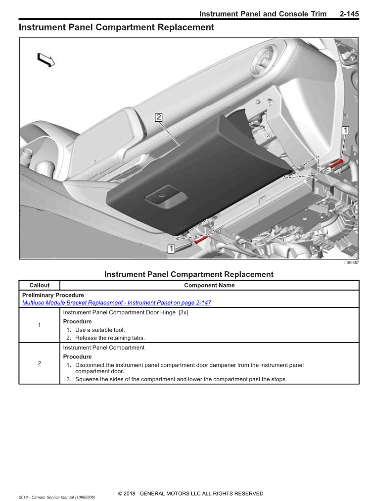

Two years ago I took apart of the right side of my dash apart. I was looking for the satellite radio antenna connection as well as the USB connections, which I found.
But the heat and my ADD got the best of me and now I forget how everything goes back up inside the right side of my dash.
Is there a video or dash blueprint for assembly or disassembly of the dash.
My car is an automatic 2017 V6 Camaro RS Convertible.

Best I could find for a 2017 V6 'Vert:

Chutzpah is right, just let someone with no back issues take care of this. I installed the RGB footwell lighting kit lying on my back, head down in the footwell a few years ago, and still remember the woes.
Here are two screenshots from the service manual, these may help, depending on the extent the dash is disassembled. If it's completely apart, you'll need the service manual, it has all the assembly information over lots and lots of pages. You can get it online from ACDelco TDS with a 3-day subscription that already allows you to download as much as you want.
