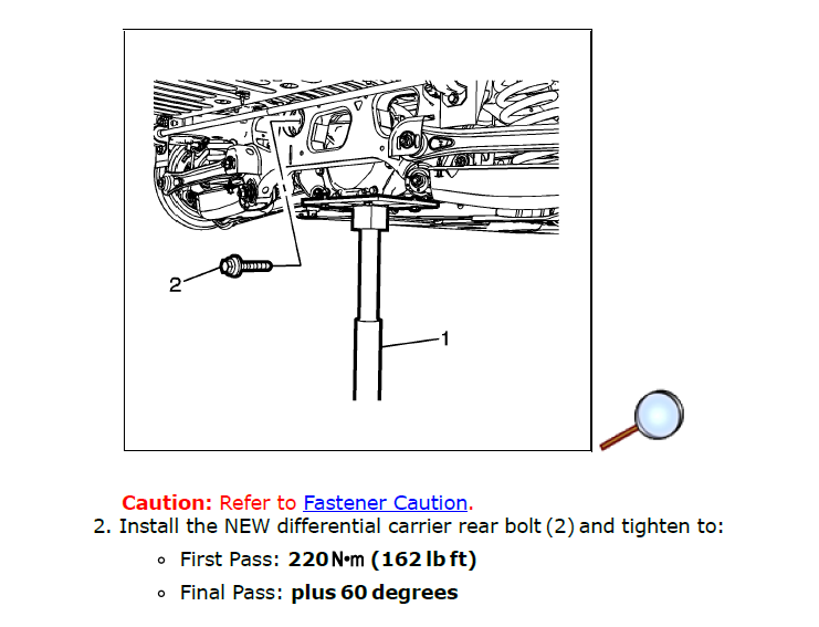

I'm showing part #11611275 for this single use bolt.
BOLT,DIFFERENTIAL CARRIER REAR
AG, AH, AJ, AK37-67 * (SINGLE USE)
Callout: 5
List Price: $2.77

The two different part #s have two different thread specs. Also the 11611275 has a captured washer where as the 11609598 has a flanged head. Should be easy to see what appears to be the correct #.

Ok thanks, I've updated original post with correct part #. Where did you get that schematic from? Way more clear than what I was able to find.
Christian1LE is offline   Reply With Quote

repairlinkshop.com
