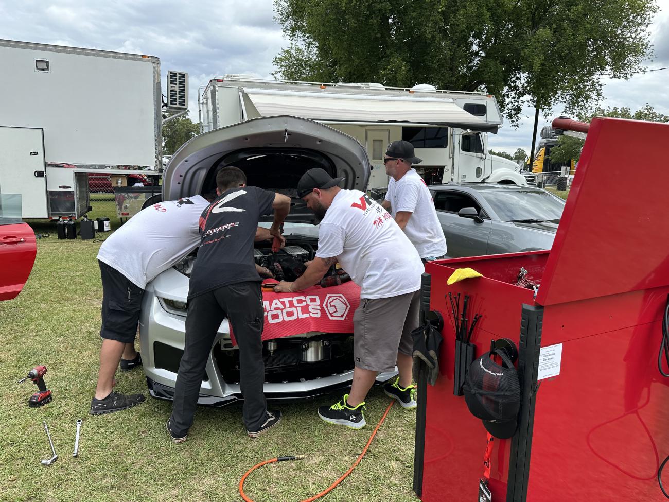

We have swapped mine in less than 2 hours at the track between qualifying and eliminations, but there were a few guys on it. If I had to guess, the billable hours is probably 5 hour off and 5 hours on.
