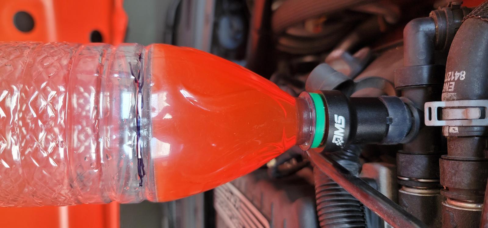

Latest how-to video on how to bleed the ZL1 supercharger coolant system:

Nice! Took a similar approach recently w section clearish hose, funnel and long drill or dowel to actuate the valve. Took a few tries, but appears to have removed all of the air, ran a track day w no issues.

The little adapter made by dedicated motorsports is such a handy tool, and at only $15 it's cheap enough that anyone with an LT4 should have one!

I bought the adapter but it has no O-Ring or I don't have one, and it just made a mess but then I understand that street cars this really shouldn't be a thing that is necessary to do as any routine.

Was the O-ring inside the adapter? When the one I used arrived, the o-ring was inside the adapter, and it needs to go around the bleeder port on the car.

Ty, just did this as well. Ran the pump for 4 minutes. Also checked my bypass valve and loosened it about 1/4 turn.
