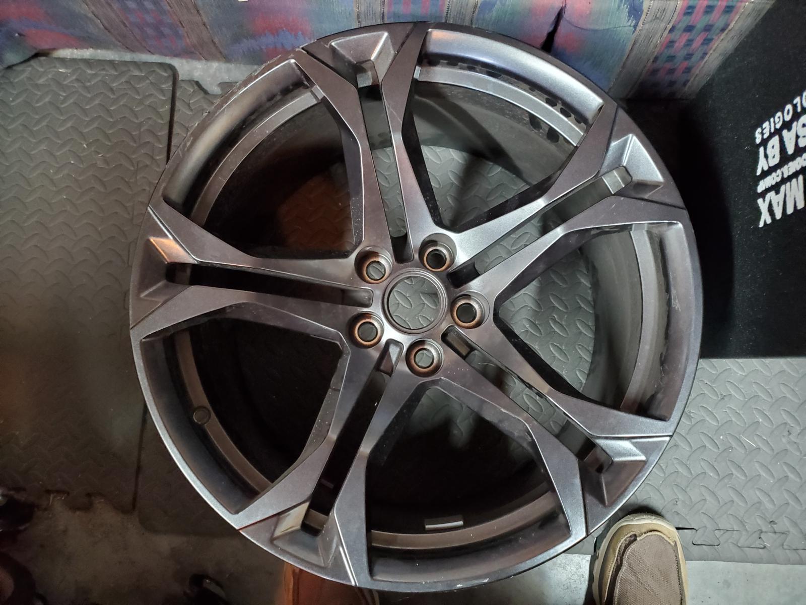

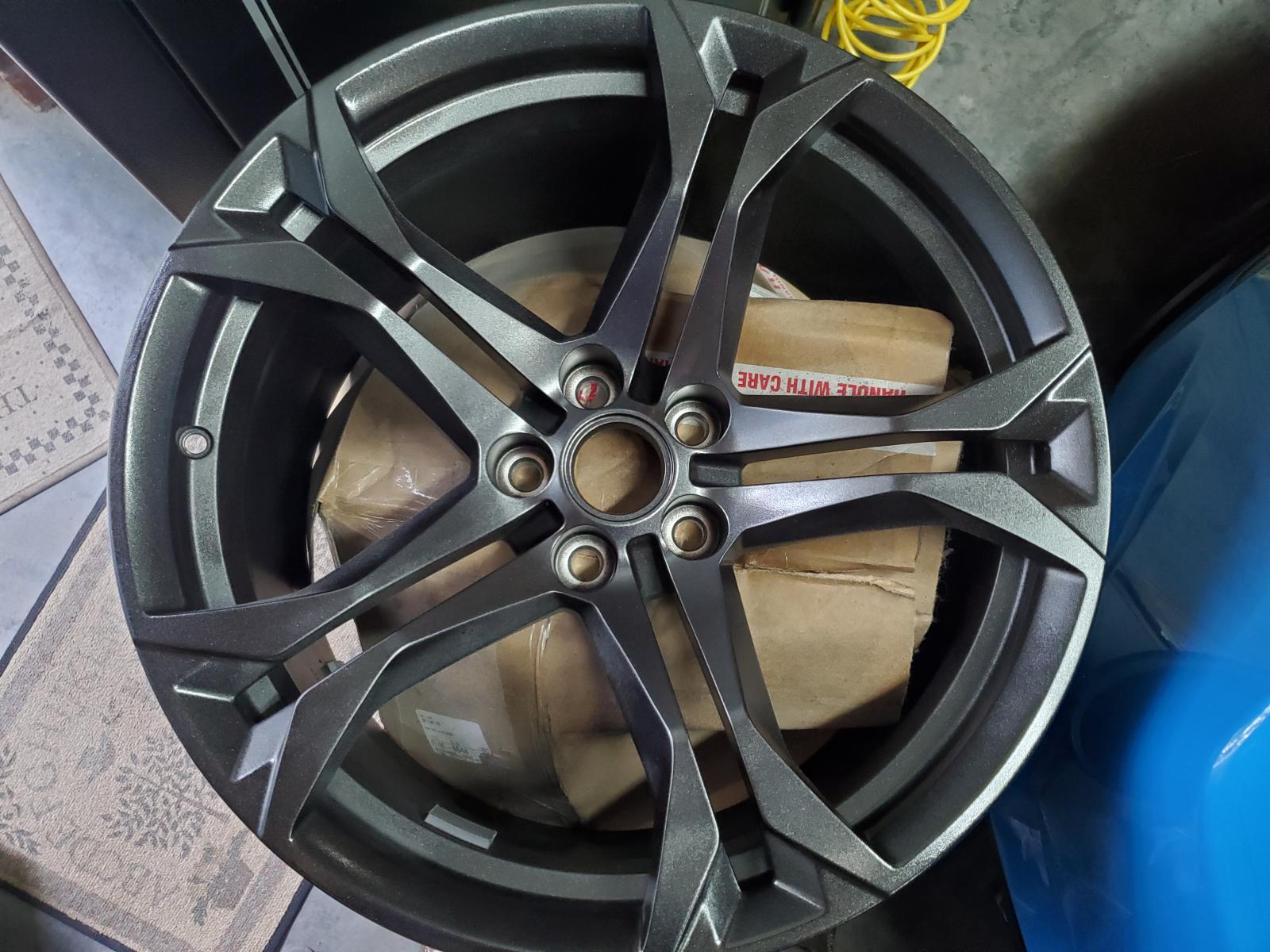

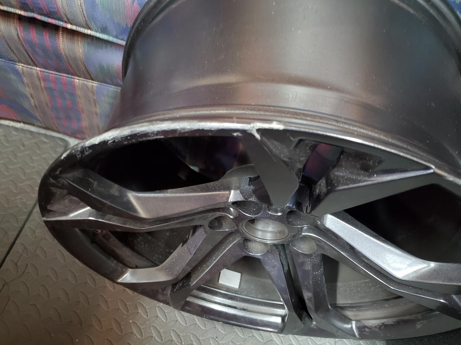

I recently repaired the wheel from my car that was damaged in the accident I was involved in back in March. Insurance paid to replace the wheel with a new one, but I wanted to keep the old one and fix it so I would have a spare. I purchased a spray can of Satin Graphite Metallic paint, which appears to be really close to the OEM color of the wheels. However, it also has a bit more metallic flake in it and it lays down more matte than the wheels. So after I painted the wheel I put a couple of coats of gloss clearcoat on the wheel and it turned out really close to the OEM finish. If I had some satin clearcoat I would have probably used it instead
In my opinion small touchups are fine just using the Satin Graphite Metallic paint, but a larger area probably needs some clear to make the paint look more like OEM.
Here are pictures of the wheel I repaired. I think it turned out pretty good.

I agree with arpad_m that the finish on the 1LE wheel is more of satin than a matte or gloss.
Congratulations on the repair job, it turned out amazingly good.
Yeah, so look at the picture below I just took, you can see the ton of metallic in the paint, which my touch-up stick matches perfectly, but there is a sheen on top that I'm leaning towards coming from satin clear coat.
That's what I would do if I messed up my wheel, spray paint with clear coat, just like ZPirate did, but I'd use the satin 2K clear. Someone here sanded down their ZL1 carbon fiber dash panel with 600 grit, then re-cleared it with satin, and it came out better than stock, not as glossy and very high end.

Wow you did a great job and possibly motivated me to try and fix it myself haha. In my case like I mentioned up top I did something stupid and messed up the finish on one spoke of one wheel. No curb rash or anything. If I don’t point it out it’s not noticeable but me being a car guy it’s the ONLY thing I look at haha.
