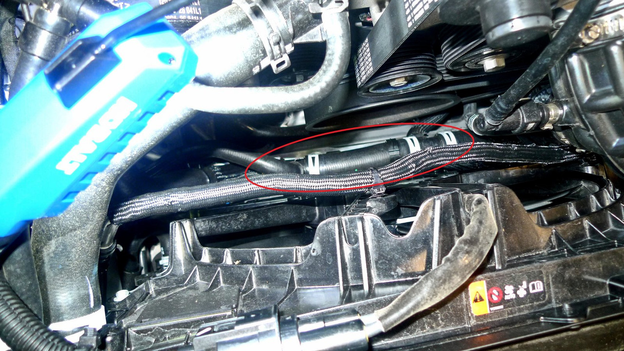

I was just poking around my engine bay yesterday, when I noticed a missing bolt on the aluminum cross piece below the thermostat housing. That bolt fastened a hard line to the cross piece with a cushioned clamp.
Once I started looking further, I noticed that the coolant line was resting on the hard line, and the clamp on the left in the second picture had scratched the top of the hard line, and was damaging it. I also noticed a very small piece of rubber held on by a single zip tie, that was supposed to cushion the hard line from the clamp, but that had moved from its proper position, allowing the clamp to dig into the hard line
I ended up buying some rubber hosing, and cut a 6 inch section, sliced it, and zip tied it onto the hard line in 3 places, to prevent further contact. I also beefed up the clamp holding up the coolant line with an extra zip tie.
Have a quick look at your car. You might have the same situation, with that clamp slowly digging into that hard line.

Thank you. Can you please take a zoom out pic of engine bay and circle where It is at?

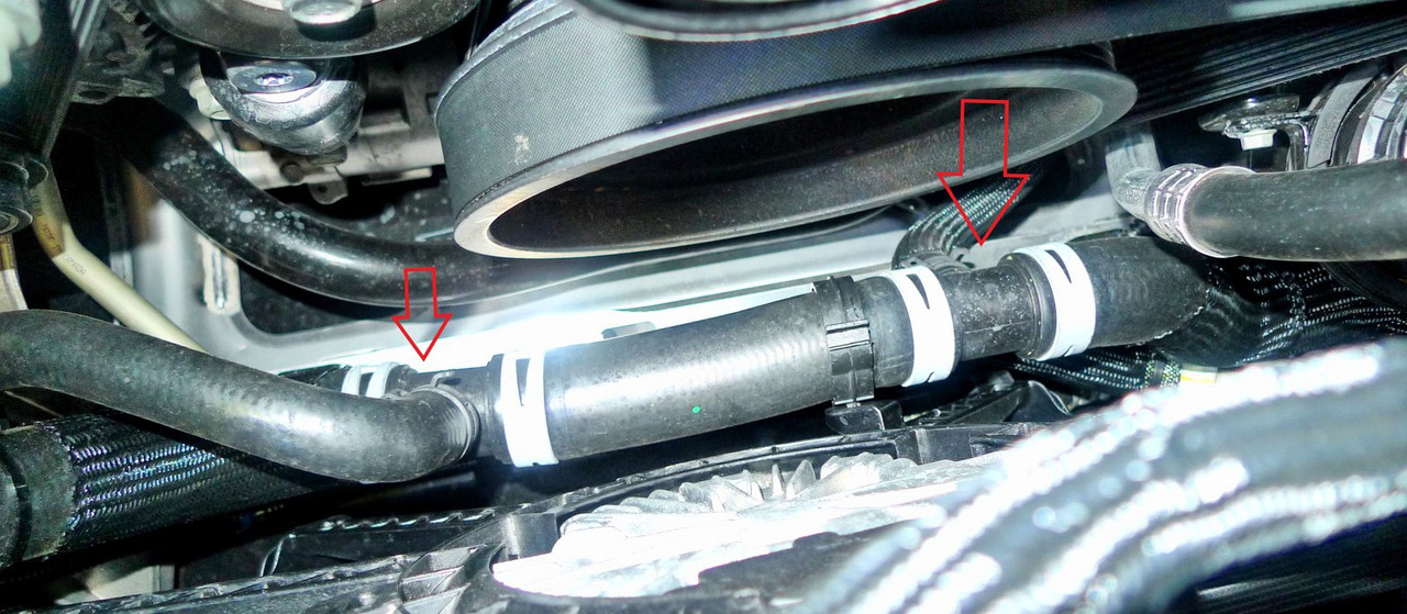

Mark R, Thanks for bringing this issue up.

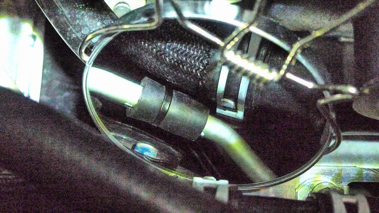

Here are a few photos that help point out the area of concerns. The picture with the two arrows, if you put your fingers under these two areas, you will be able to feel the smaller metal tube against the larger hose. Check for ample clearance. You can move the larger hose assembly around somewhat and see the areas of concern better. The only area that the clearance is tight on my car is the left side. The close-up picture (using a mirror from the back side) shows it has just enough clearance but not much. I may move the abrasion sleeve a little, probably rotate the clamp a little to help increase the clearance gap. I will keep an eye on it and if necessary, add some more abrasion sleeve material.
There you go. The abrasion sleeve on your car isn't in the correct position to stop one of those clamps.

In the mean time, I slide the abrasion sleeve to the right (rubber hose with zip tie) down towards the kink in the metal tube, so it is directly placed where the hose clamp is. Even then, I have ample clearance between the hose clamp and the abrasion sleeve. I did not attempt yet to rotate the metal hose clamp, but not easy to get to.
