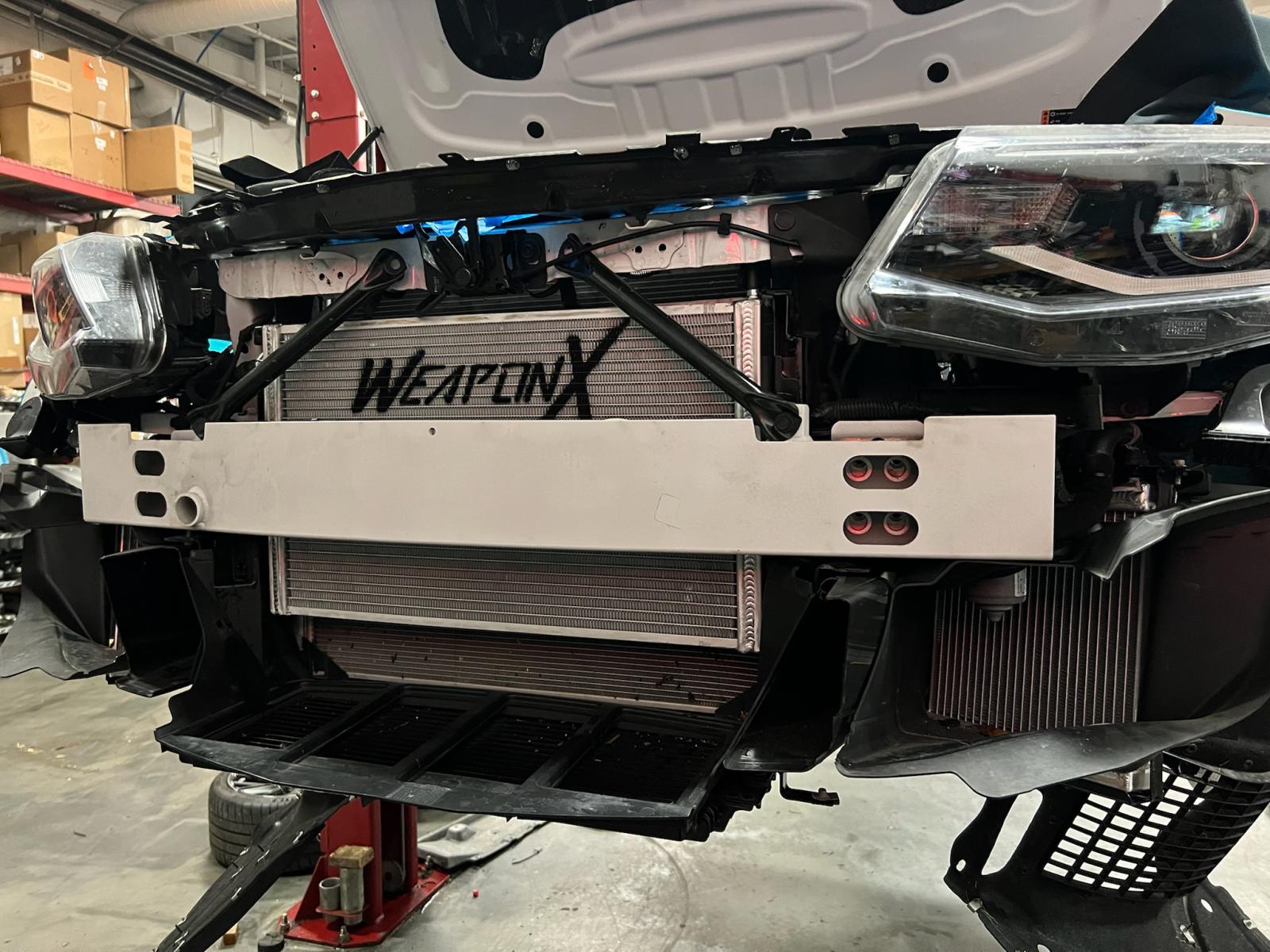

Please report back on the fitment and quality if you do order them though. I have been curious about them since they are so cheap. I just recently ordered the Weapon-X triple exchanger set with the black ice coating. I think a lot of people want to know if SE is a quality option.

I have the WeaponX triple exchanger set and am very happy with those.

Thanks for the feedback! I considered the SE exchangers, but this is a brand new, nice car, I just didn't feel right about putting a cheaply made (unknown quality) parts on. Plus the black ice coating should help even more with heat soak, so I felt it was worth the extra money.

I have them. They add capacity but be aware that the brackets for the small heat exchangers have to be modified a bit to fit due to the bigger tank size which also interferes with the rock guards in front of them. I had to shave about 1/4" off them where they butt up to tanks to get the rock guards to fit correctly. Not too bad to mod overall though.
At the time, I measured the exact amount of coolant I gained but of course I then lost track of the paper I wrote it down on. Between the 3, I think it was a bit over 1 gallon. 1 small cooler is for the engine FYI.
I believe I picked up about .5MPH in the 1/4 mile by just doing this. The car consistently trapped 124something before and now traps 125 consistently.

This is why you upgrade all 3. The center and drivers side are for the supercharger coolant. The passenger side exchanger is an auxiliary radiator, so it should cancel out the loss of flow to the main radiator from the center exchanger. You could potentially have a performance reduction in your A/C system due to the condenser being partially blocked, but I doubt it would be enough to notice.

From all the ones I've looked at, while having similar shape, I have noticed that some have taller and/or thicker cores. The main concern for me though is the weld quality. WeaponX, as well as others like LMP, are made in house, hand tig welded, and pressure tested before they are shipped. The Speed Engineering are definitely made in China and are machine welded. This isn't necessarily a horrible thing, but it could be a higher potential for leaks. Like I said before, I was considering these, but I just decided to go with WPX for peace of mind. Plus I really like that they offer the black ice coating for better heat dissipation.
