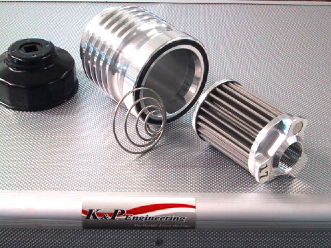

What do you guys think of this? Any feedback? Sorry if this has been posted before.
It is a re-usable filter that is machined from billet aluminum and uses a fine surgical stainless steel mesh to filter the oil. It filters down to 5 microns and 1 square inch of material flows 1.9 gpm
https://kandpengineering.com/product/S17/
Cleaning video:
Eric Darr of Dimple Products mentioned it to me when I ordered some magnetic drain plugs. His magnets are installed into the filter as an extra measure to attract metal particles.

The problem is the filter does not hold any material, it only blocks it. So, when you shut your engine down it goes back into the oil pan. That's what it seems to do anyway. My Harley had a lot more junk at the bottom of the "pan" with this filter.
