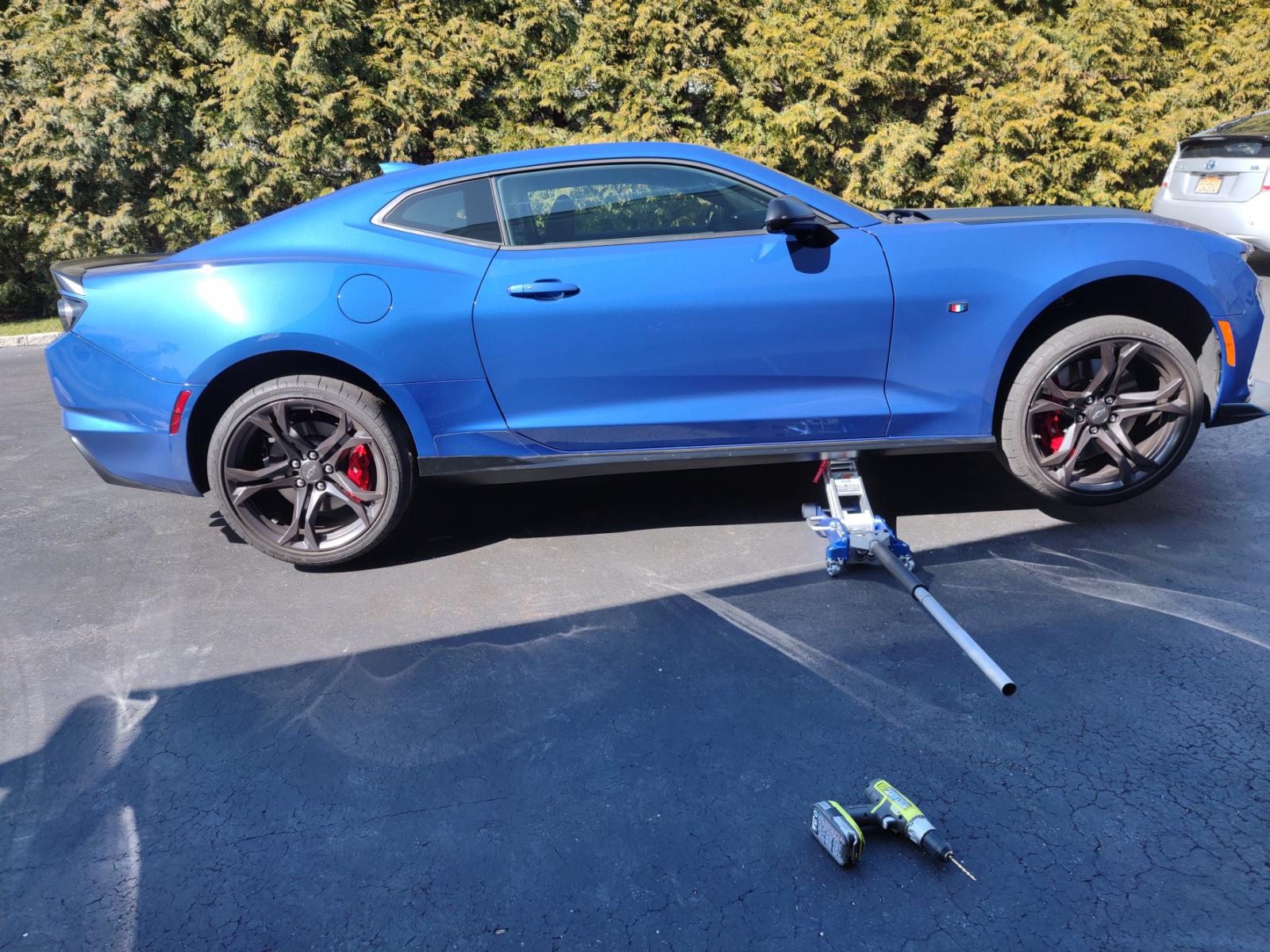

Question Lifting one side of car with floor jack?
Picked up a 2023 SS 1LE a few weeks ago and just did a 500 mile oil change and plan to do the rear diff today or tomorrow. After doing a lot of reading on this site I purchased a set of ZL1 Addons lift pads and their lift puck also. Worked great for lifting the car and placing the front on jack stands.
But I do have a concern/worry. I had to lift the front about a 13'' off the ground to get my jack stands underneath. I noticed the rear tire lifted also. I know these 6th Gen Camaros are super stiff, but is it really ok to lift the entire side of the car like this? I was honestly worried about tweaking or bending something as I was doing it. It must put a lot of stress on the body lifting the entire side from one point, no? Anybody ever have a problem lifting the car like this?

Yes it's fine. When I use jack stands ill use the front jack point to get the entire side up, slide jacks underneath then go to the other side and do the same.

Car is designed to lift one entire side on the jack point, it is absolutely ok! Miatas do the same thing

I agree, it's fine following the jack pads and/or pucks.

I do the same all the time - use front rearward most jack point to lift front and rear tire clear off the ground, makes for quick tire change.
