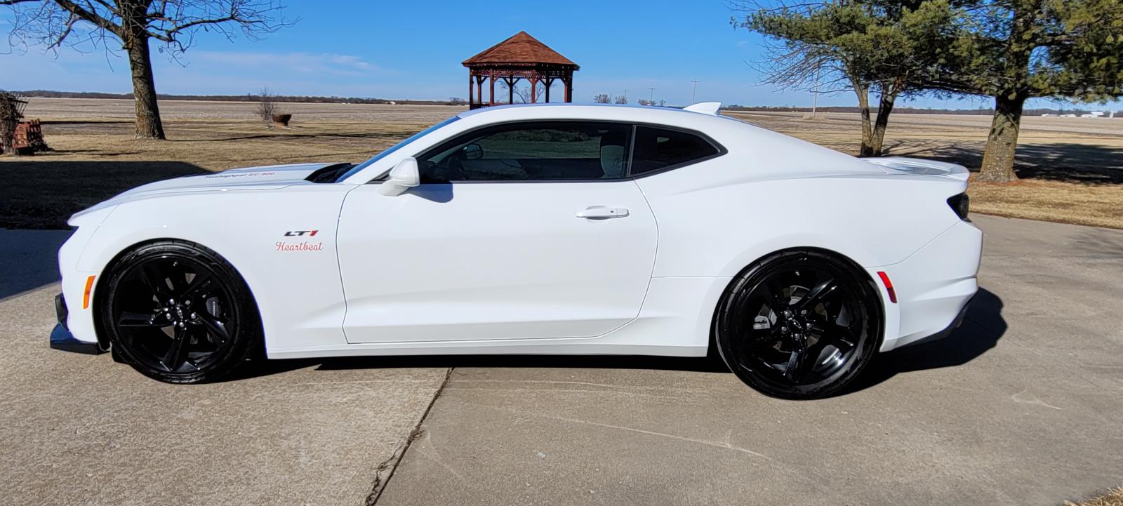

If somebody has had an alignment and the caster is off and moved to tire to far forward they could rub, but if your tire is center in the middle of the fender well you should be fine.
