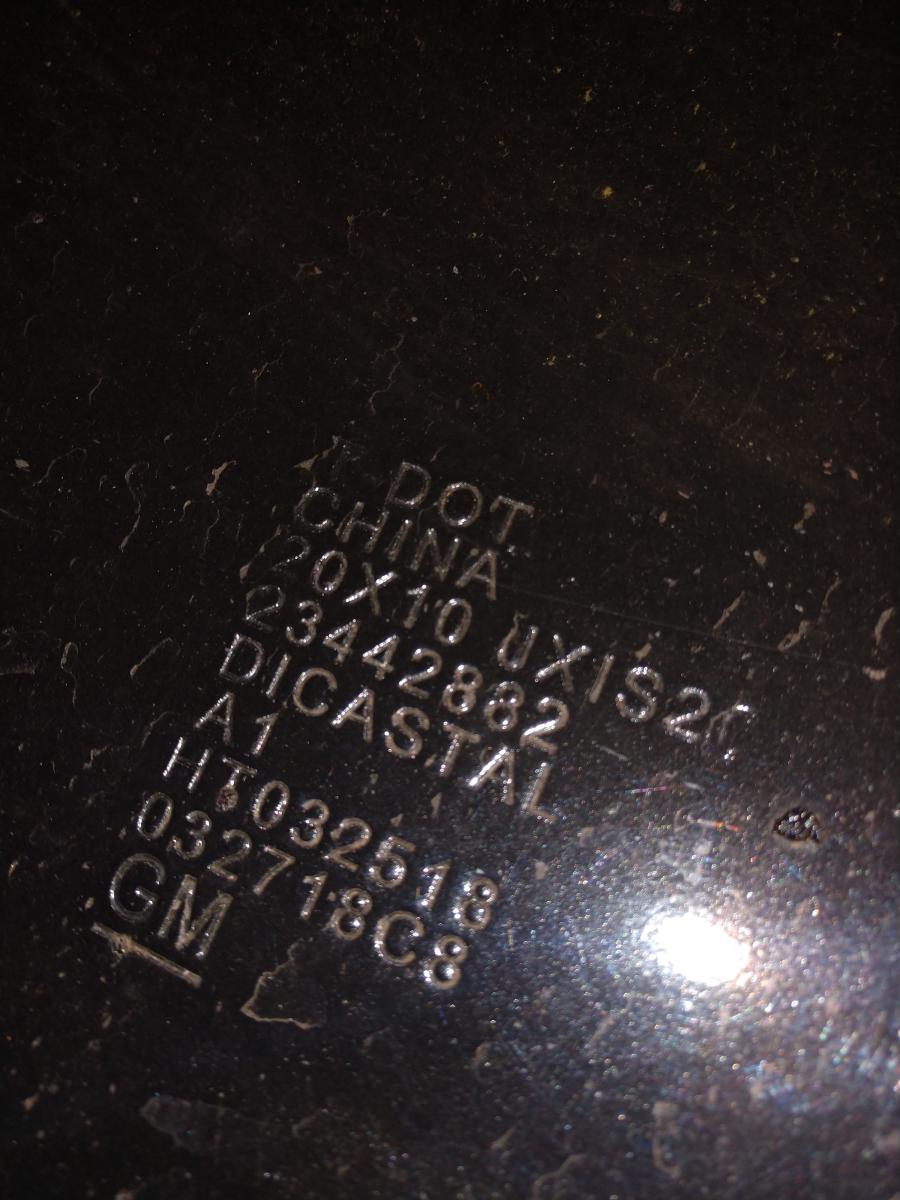

Hi,
Needed a front rim for my 2019 ZL1 (Non 1LE)
Damn Michigan pot holes!
I ordered a new front rim from my local GM dealer.
Part number ordered was 23355790
I received the rim today. Part number on the outside of the box matched the above.
Upon examining the rim inside the barrel, the part number is stamped as 23442882.
Any explanation as to why the different part numbers?
Perhaps 23355790 is the final painted assembly and the 23442882 is the cast or forged part before the painting process?
Any input would be appreciated.

It could possibly just be the new revision part number for the same thing (i.e., the old part number points to the new one).
Mods being installed-
Old 05-02-2023, 07:00 PM   #4
Posts: 13,476
For what it's worth, my SS 1LE wheels (also made by Dicastal) follow the same pattern, a different part number is stamped into the wheel than the one used for ordering.

The original wheel that was on the car from the factory had the same 23442882 part number stamped inside the wheel.
Just for future reference in case anyone else runs in to this issue.
Since the usage 23355790 ordered part number shows that it's the same wheel 2017-2023 model years.
Perhaps the supplier ran out of the correct paint color?
This is a photo inside of the original removed front rim.
