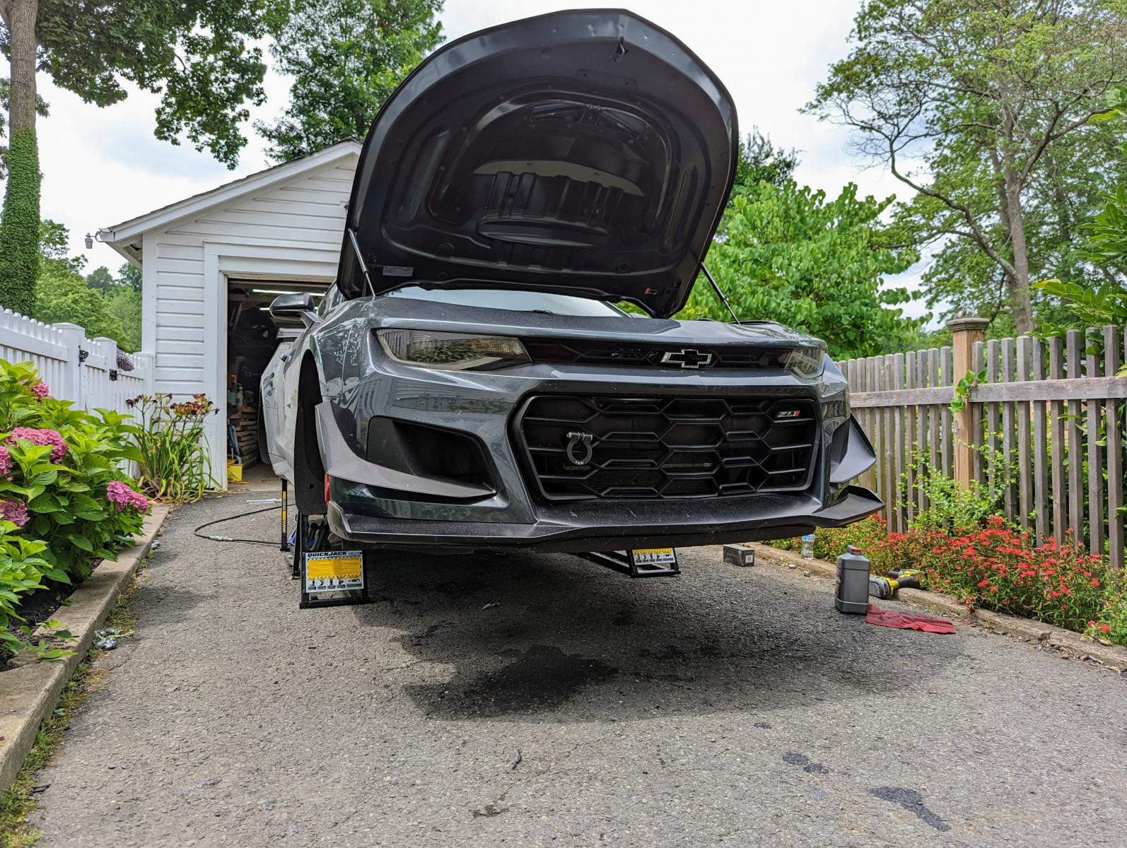

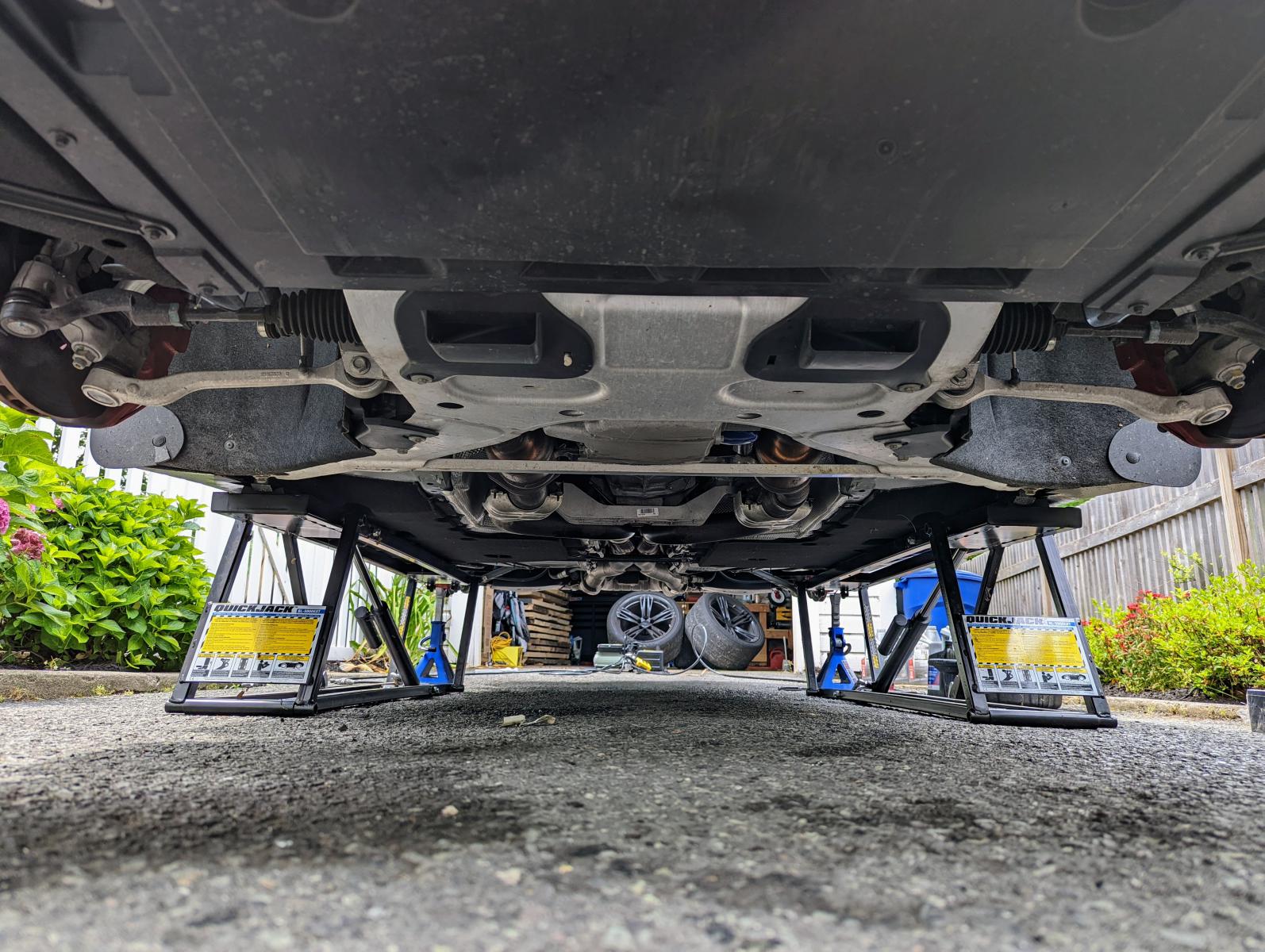

I have 5000EXT. They no longer make that model. It has been replaced by the 5000TLX which is the one you want for the Camaro. It has the same extended frame length as the 5000EXT but lifts the car a few inches higher. 21" for 5000EXT. 24" for 5000TLX
If you plan to use the QJ on any trucks or heavier vehicles, step up to the 7000TLX.
