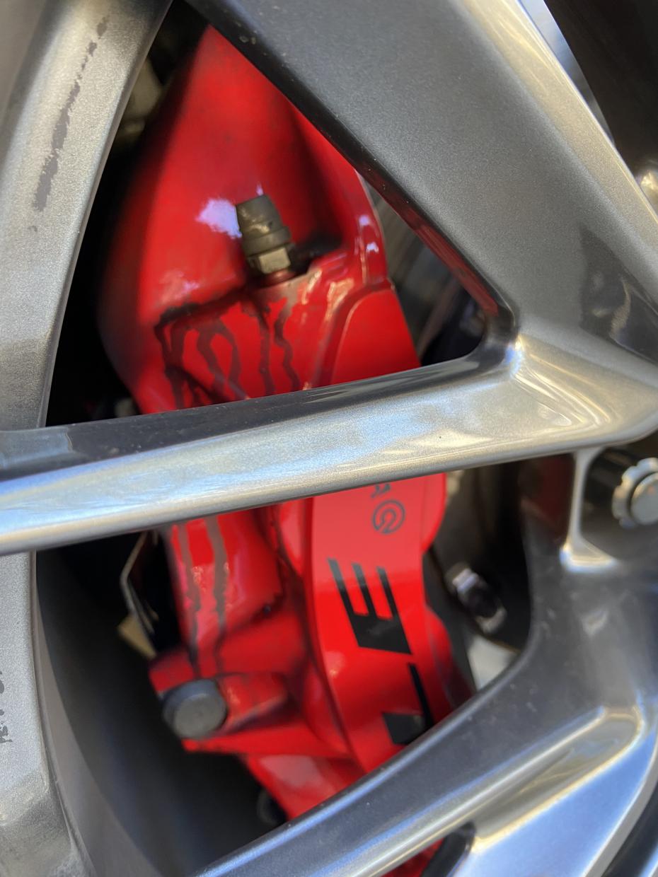

When you guys say your calipers are weeping, how much fluid is exiting and how often?
I ask because I've seen that after you bleed or flush the fluid, there is residual fluid inside the bleeder screw/housing that ultimately weeps out during track days. It does it once however, and not again (until the next fluid bleed/swap). You can minimize this by rolling up a little shred of paper towel and inserting into the bleed screw opening to soak up what's inside.
Or is it weeping each and every time you use the brakes heavily?

Every time I applied brakes.
An example. I found this after my track day where I had freshly bled brakes and changed fluid brand for the start of the year. Knew I had cleaned them after bleeding.
Attachment 1124418
Did the brake fluid damage the paint on your calipers?
Nah, it all wiped off. It’s just dirty from brake pad and track dust that day. ;-)
