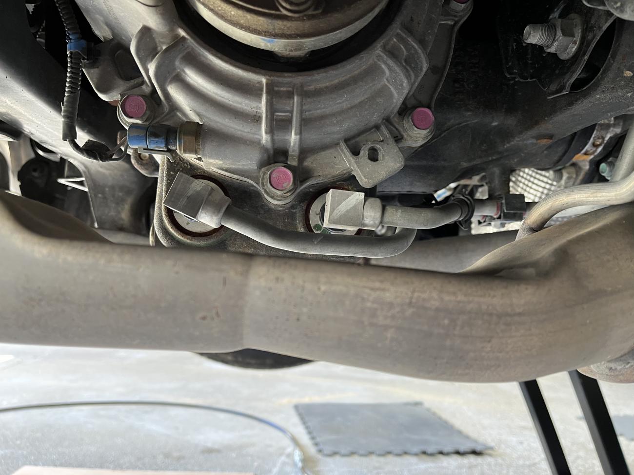

ZL1 exhaust engineering
Really nice engineering GM!!!

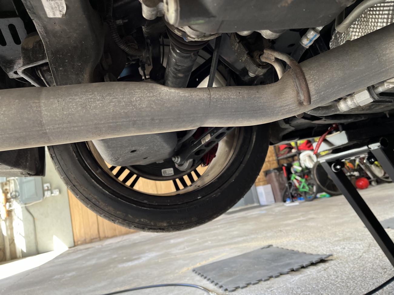

I've owned mostly vettes and they route the exhaust over the axle. Point is why couldn't this be better engineered like the vette's just gives the impression it wasn't thought through it is a substantial collapse in the exhaust beyond an ovel shape.

With the price and engineering already in this car's handling/performace ext I'm just surprised/disappointed. if aftermarket exhausts R and D figured out why couldn't GM. Why not make the rear section oval for clearance?
And even if they were a round shape, the car would make the exact same power. Plus they have been doing this on other cars for decades. 04-06 GTO, older Camaro's/Trans AM's, Silverado's, etc.
It only really starts to matter once you start pushing 200 or more rwhp and even if the car had a normal oval exhaust, it's going to be changed out by that point anyways.
The real reason why it's like this is because of the convertible. They have a brace there and need this crimp there. So they didn't make 2 separate productions of exhaust for the convertible and coupe. It only really makes the sound different.

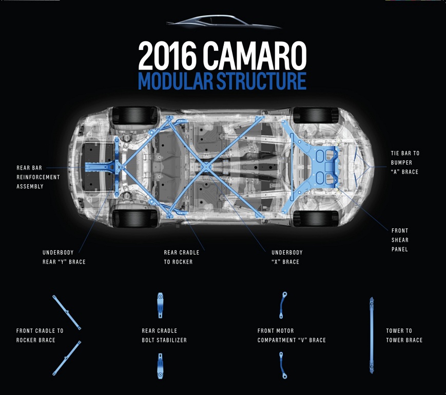

The vert (and cost saving) is the answer indeed. Here is an image to illustrate the reason, the cross braces are only used with the convertible for additional body rigidity.
