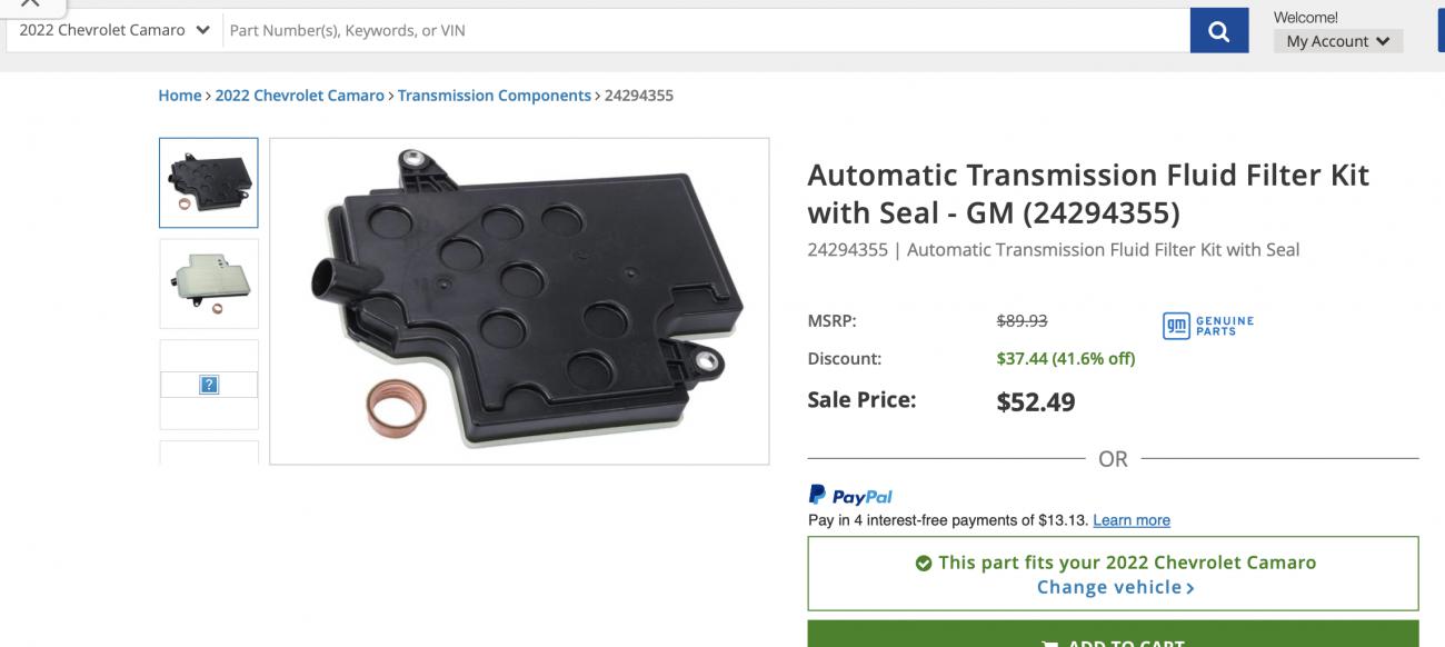

I have a new 2023 ZL1 1LE with the 10-speed automatic transmission, and I am approaching the 15-hour track driving interval GM recommends for servicing the transmission. None of the online GM parts vendors show part numbers for 2023 ZLEs; the latest they show are for 2022 cars. Can anyone confirm that the following GM part numbers for the A10 pan gasket and A10 filter are the correct ones for my car? Also, how many quarts of Dexron ULV AFT should I get? I see 6 or 7 quarts recommended on other posts. Finally, anything else I need besides the ATF, gasket, and filter to complete the job (will be done by a local speed shop). TIA!
Auto 10 Gasket: For 2022 it says GM part 24297886. Does anyone know if this still is the part I need for my 2023?
Auto 10 Filter: This part says it fits a 2022 (GM Part 24294355). Is it the same for a 2023?

24297886 & 24294355 are appropriate for a 2023.

You'll need 7 quarts.
