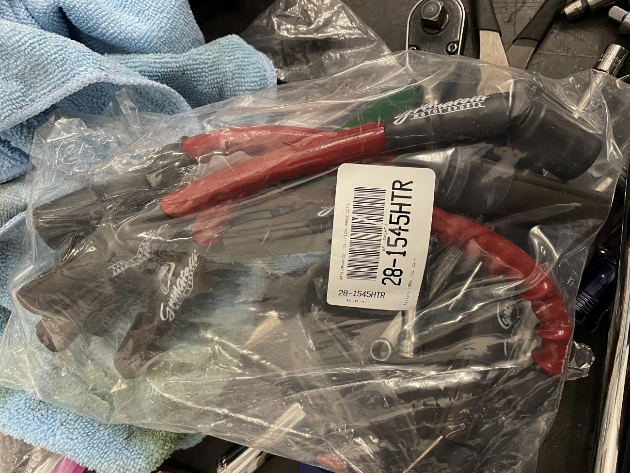

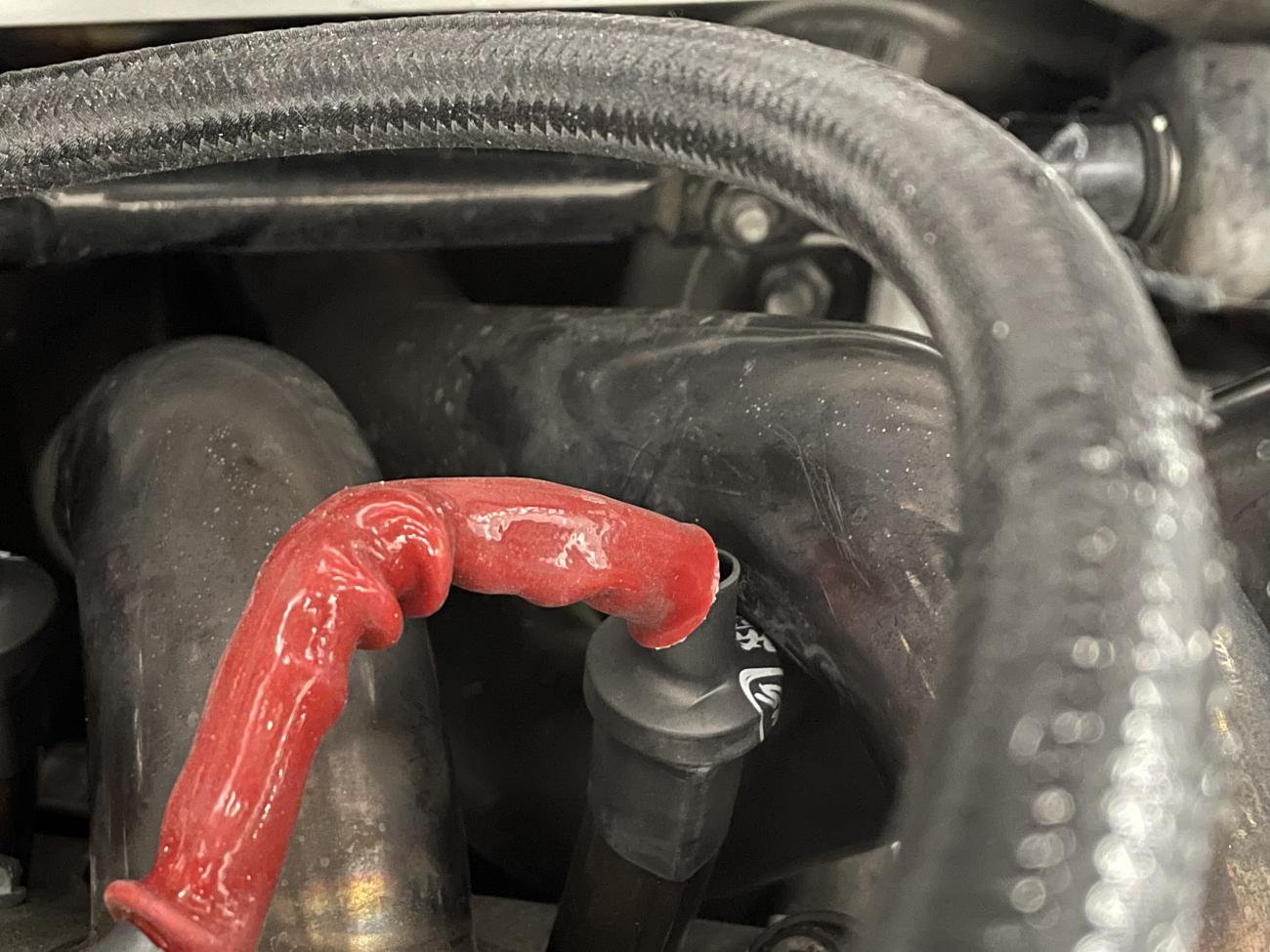

Jus curious if anyone else has had this problem. One of my Accel wires came apart when I was changing plugs so I decided to go with a new set of Ganatelli wires after reading positive reviews here. I didn’t get very far, on the 2nd plug wire from the back on the driver side the plug wires is pushing up tight against the header. My accel wires were angled and didn’t have this problem. I don’t think you would want anything touching the headers… Not sure what brand they are, they came with the car.

SO many threads. Buy the Speed Engineering 12" long wires and you should be good to go. They are the best for headers.

They are bendable, bend them to fit.

I’m running the Granatelli ones with 2” primary headers with no problems. Part number 28-1545HTRB.

I have 2" ARH headers with Granatelli and no issues.
how long are they online it says they are only 10.5 inches did you get a different one.

As a side note to my post above: I ordered custom length wires, and didn't go with off the self length wires. I figured by doing so this would eliminate any guess work on the length etc. Granatelli was easy to work with and the custom order form is straight forward etc. Good luck!
